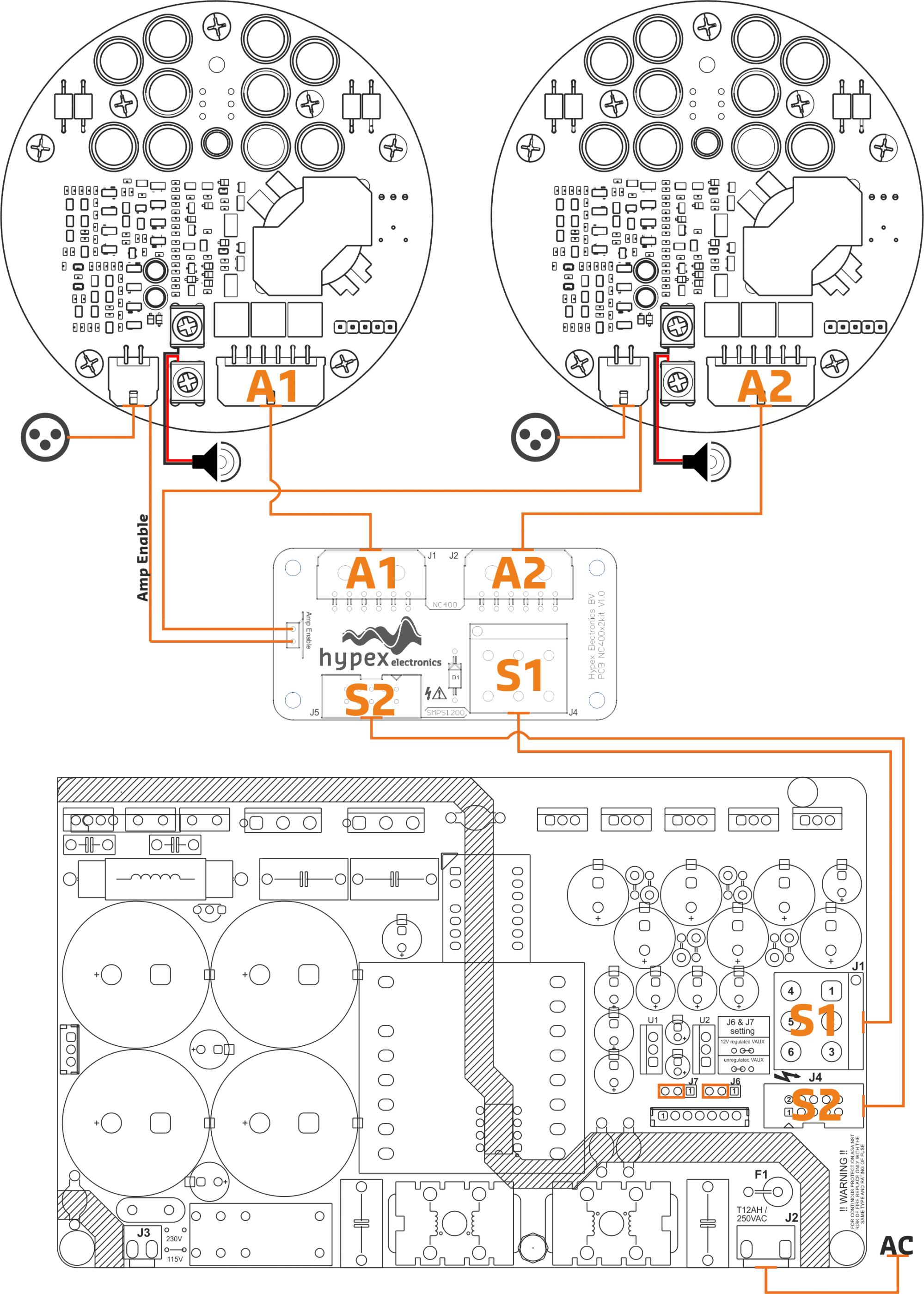

Just wonder, how two jumpers on the SMPS1200A400 have to be set (J6, J7) for the AUX voltage, wehen using it in combination withe the NCores. Should they been set to "regulated" or "unregulated" Aux voltage ?
Drawing adapter kit 2x NC400 <=> SMPS1200A400
The attached diagram shows it all.
It is supposed to be available "shortly".

Note: The diagram in my previous post states, that VAUX has be set to "Unregulated" (J6+J7 on the SMPS1200A400). The nAmpon signals are supposed to be soldered to the small (intermediate) PCB provided with the kit.
