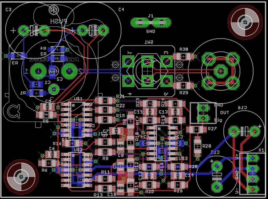

PS: here's a little buffer I've been working on. Three quad LM4562 equivalents. Nothing to do with Hypex and so very off-topic but it does make me want to turn my attention to a Hypex buffer at some stage.

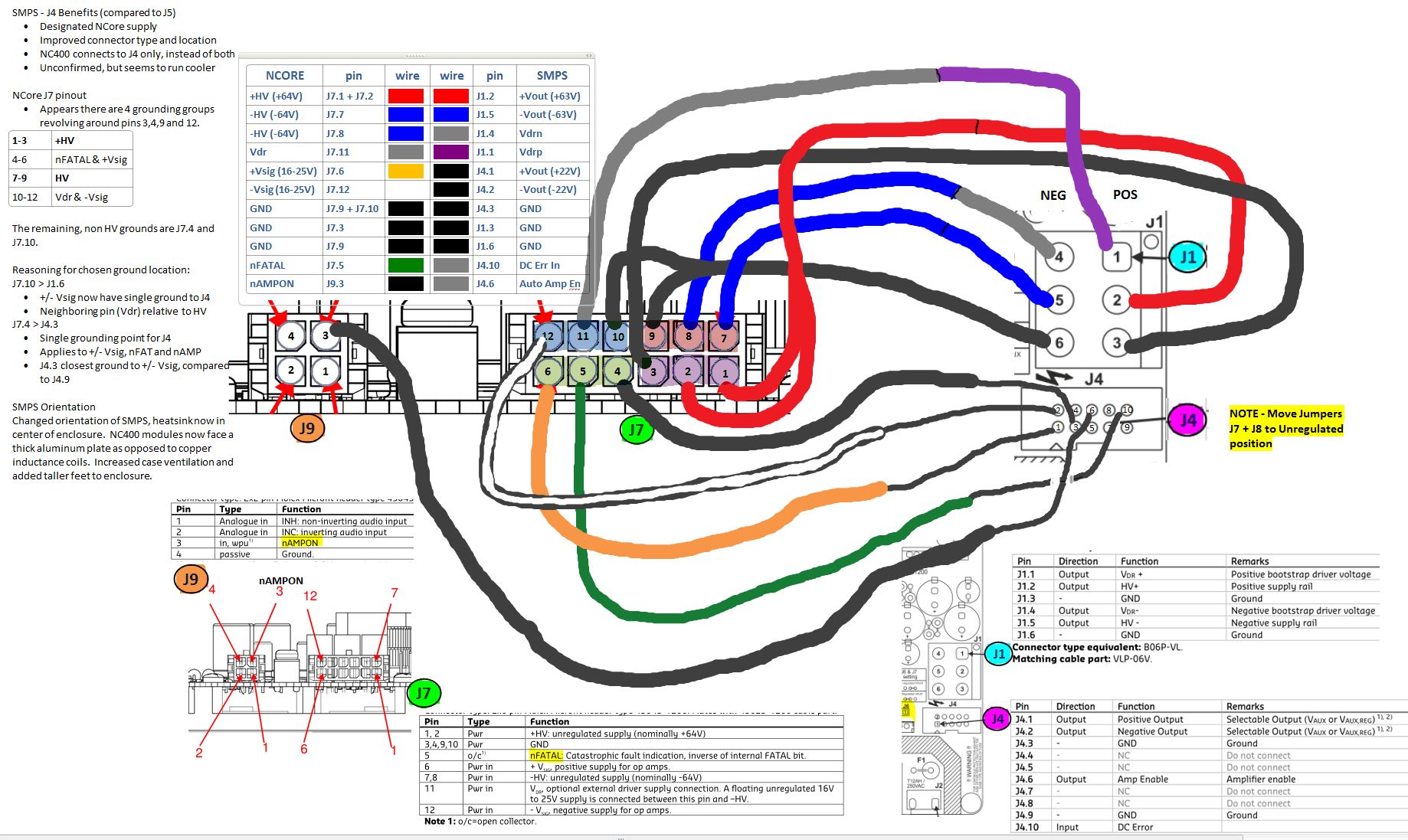

The SMPS1200A400 offers two power outputs, J4 (NCore specific, 2x5 IDC Boxheader) and J5 (Aux/PS control, 1x7 JST type).
Hypex support recommends hooking up to the NC400 using a combination of J4 and J5. The majority of the NC400 input cabling is routed to the 1x7; the remaining 2 wires (nFATAL and nAMPON) are attached to the 2x5.
It appears this could be a source (unnecessary sharing of ground planes?) for added noise and/or heat between the two outputs. All other Hypex SMPS appear to connect with a standard 10-pin ribbon cable only.
For the past few days my NC400's run exclusively from the 2x5 connector, without any connections to the 1x7. As best I can tell, the amp is running much cooler and the audio quality has improved significantly.
Here's a repost of the wiring diagram from yesterday.
It describes the connections used and touches on some other aspects (J7 grounding scheme and SMPS orientiation).
Unlikely. The ground isn't really an issue, and just wiring topology won't affect heat.
What is important is that the nc400 receives a suitable voltage on pin 11 of J7. Would it be possible for you to measure the voltage between pins 11 and 7 (or 8) on J7 on the nc400? The presence of the right voltage there definitely affects heat and probably also sound quality.For the past few days my NC400's run exclusively from the 2x5 connector, without any connections to the 1x7. As best I can tell, the amp is running much cooler and the audio quality has improved significantly.
