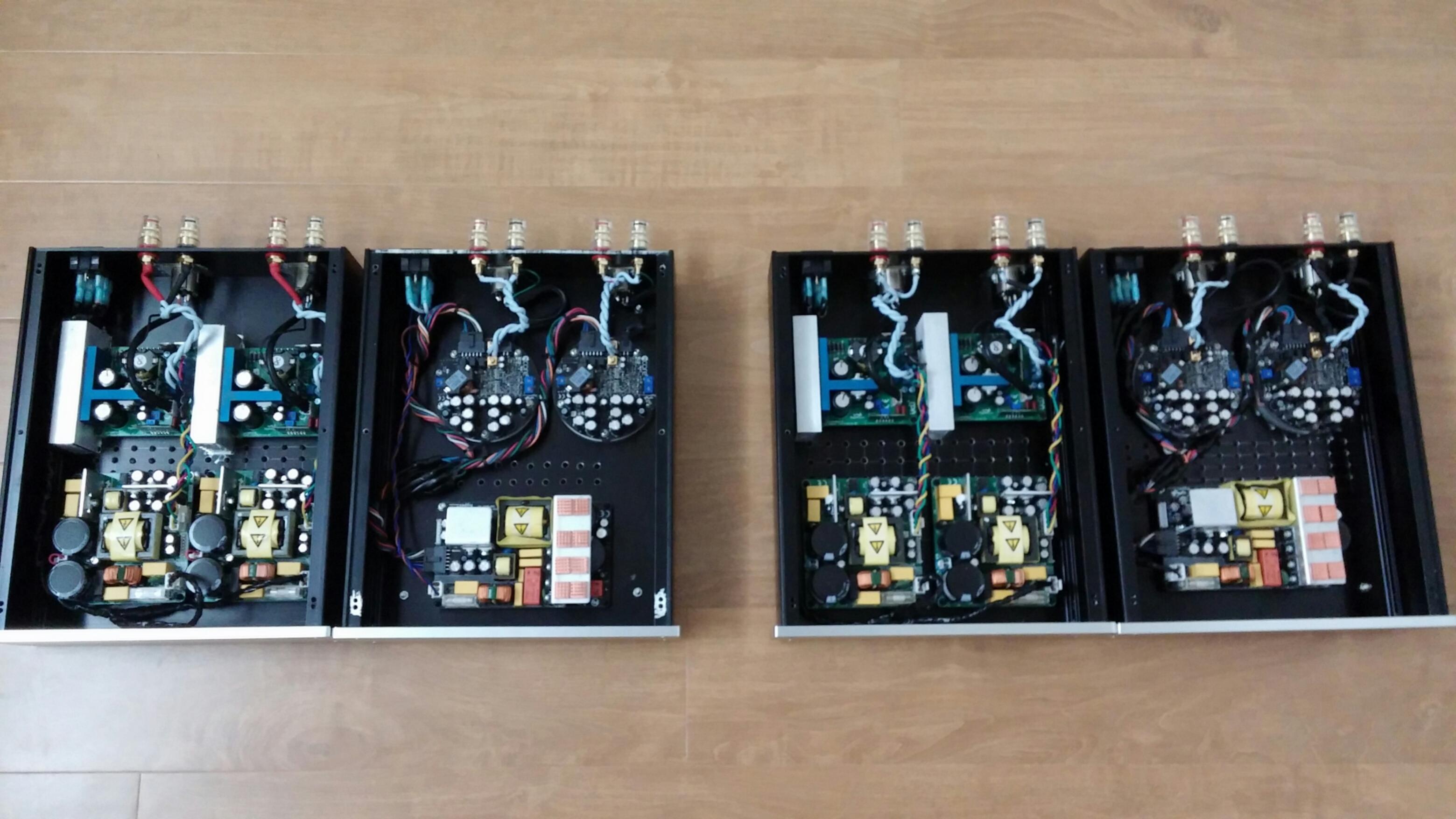

had missed posting pic of my 8chs of Hypex amps for an active 4W setup
