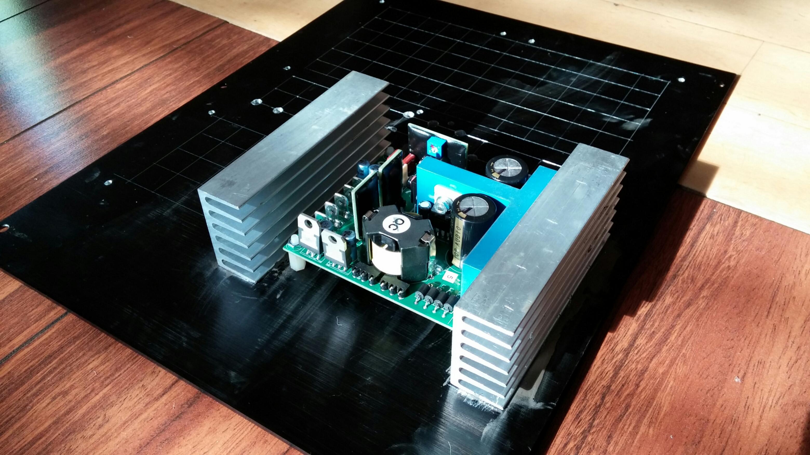

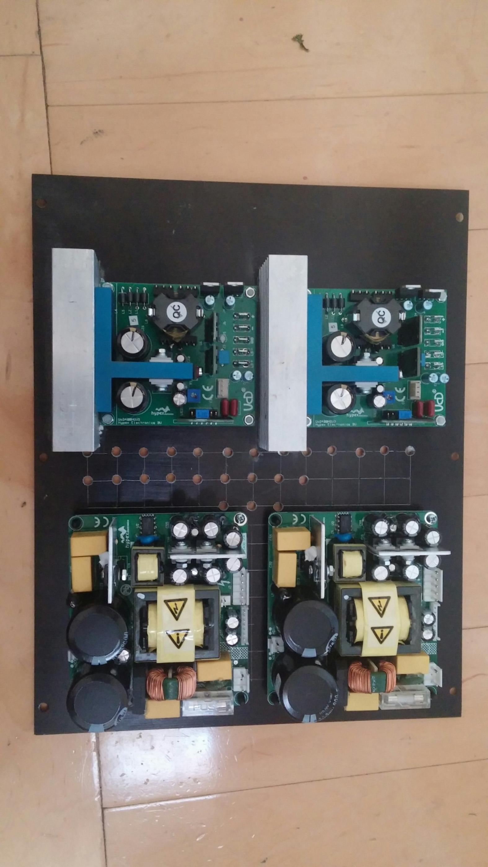

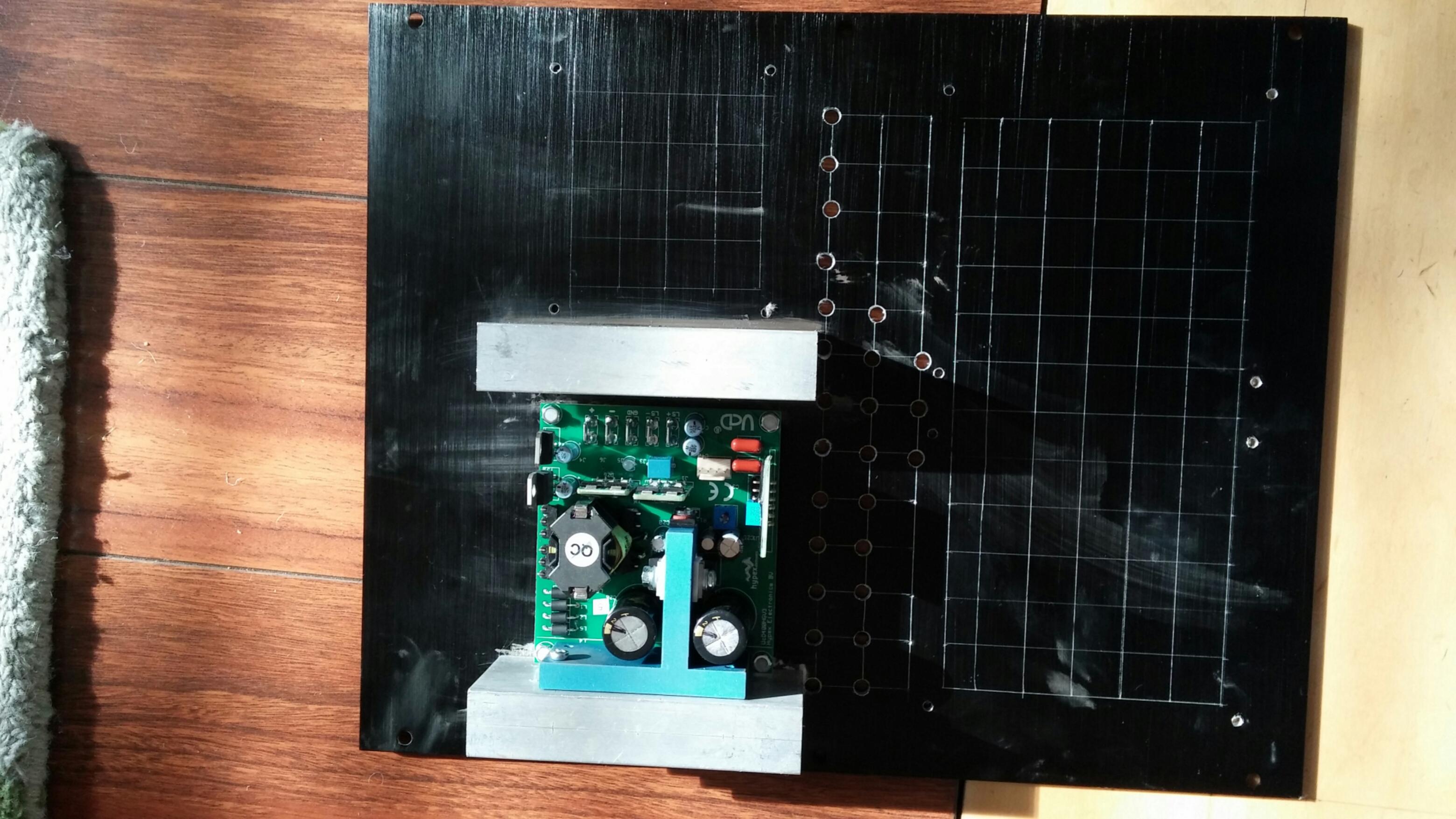

ran into some problem with the ucd400 assembly.
I just wasnt able to find a good way to fasten the ucd heatsink to small aluminium heatsink blocks which in turn are screwed on to the bottom plate of the chassis.
initially i was planning to screw the modules on to the heatsink blocks, however putting a hole thru the heatsink and getting the screw in through them and onto the module's blue heat sink was proving difficult.
Could use some heat sink adhesive pads to do the job, but may not be as good as a good mechanical coupling using screws.
The picture shows one module, the second one goes on the second aluminum heatsink. This is work in progress so pending cleanup.
