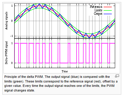

Delta modulation (DM or Δ-modulation) is an analog-to-digitaland digital-to-analog signal conversion technique used for transmission of sound information where quality is not of primary importance. DM is the simplest form of differential pulse-code modulation (DPCM) where the difference between successive samples are encoded into n-bit data streams. In delta modulation, the transmitted data is reduced to a 1-bit data stream.
Implements features and...caos...the continuos evolution for obtain high fidelity and better sn/r are:
Adaptive delta modulation (ADM), continuously variable slope delta modulation (CVSD) is a modification of DM ..etc..etc.
But (exclude particoular project), rest a fact that 1 bit is obtained and processed in analogic way. as comparator in pwm D Class.
FM is analog but you can develop as digital.
We have to consider "Digital" is a magic word for marketing also, and "caos" a magical circumstance. 🙂 as a nfb in D Class, has nothing to do with the pure nfb of an analog amplifier.

Ops!... pic
pic..
