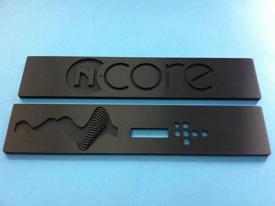

very nice.
especially that there are no router bits traces, visible especially in the "N" like with some other cases I've seen.
Italian job 🙂
Italian job 🙂
very nice.
Italian job 🙂
They sandblast it:
http://www.hifi2000.it/default.asp?id=98&mnu=98
Got a mail from Hifi2000, my cases for the Ncore's and DLCP are finished and on their way!🙂
Did they make a rear panel for the connector cutouts also?
The fronts look very good.
Yes, but I have no pictures.
