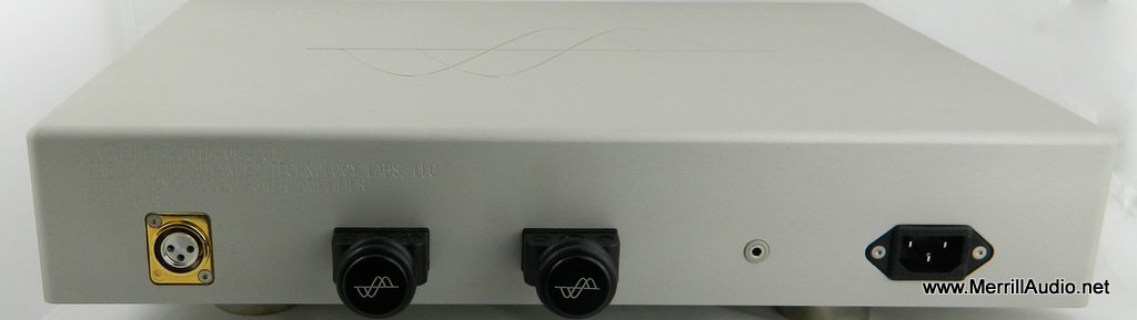

The back of the Veritas has the IEC, two Cardas speaker and the XLR connector.

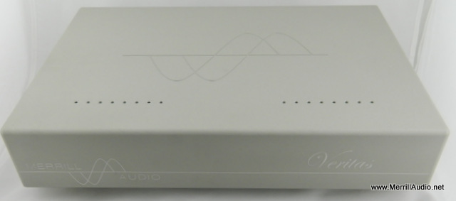

Great questions. Here are the answers.
Does anyone have any pics of the guts and back of chassis of the Merrill Audio VERITAS amp they could share? I'm not seeing this on their website for some reason. 9 pictures of the front/sides but nothing showing the back...:scratch1:
Pictures of the back are provided below and will be updated with other pictures of the Bordeaux color chassis on the website soon.
A picture of the top view is also included for the questions below and as an indication of size of the chassis.
I am curious to see if the VERITAS is built any better on the inside then the Acoustic Imagery Atsah that was reviewed at 6moons. After seeing the innards of the Atsah I'm having a hard time justifying its $9K /pr asking price. As also mentioned in the 6moons review of the Atsah I too would have expected to see some attempt at component isolation at this price point as well as a better layout of the binding posts. Maybe I'm asking for too much here but since they already went thru the trouble of using a milled aluminum chassis how much more effort would it have been to give each board its own separate area for better isolation, shielding and vibration immunity?
Hard for me not to be biased however, the answer to this is an absolute yes. The engineering thoughts and design is described on the website merrill Audio Hypex Ncore NC1200 based VERITAS Power Amp Mono Blocks
Chassis highlights – 17” x 12” x 3” exterior, 1” thick walls, 2 compartments, 3”x 3”solid center. 30 lb weight. I could not comment on the Mola-Mola however it does not have a billet aluminum chassis.

A picture of the top view is provided so you can see the size of the chassis that allows for the separation of the boards, spread of the inputs, speaker binding posts and AC input. There is plenty of room for large speaker cables and power cords. Note we supply a custom built 10 AWG power cord that is one of the best out there - not the best but a significant improvement over a stock power cord and competes with $1,000 power cords.

I have never heard so much mumbojumbo! And you are writing this with a straight face while there is a completely inferior one dollar Euro mains inlet???? 😱😱😱
4,500 dollar per monoblock????????????😕
I can't say I agree with that post but I think that at least a portion of it is not mumbo-jumbo.
