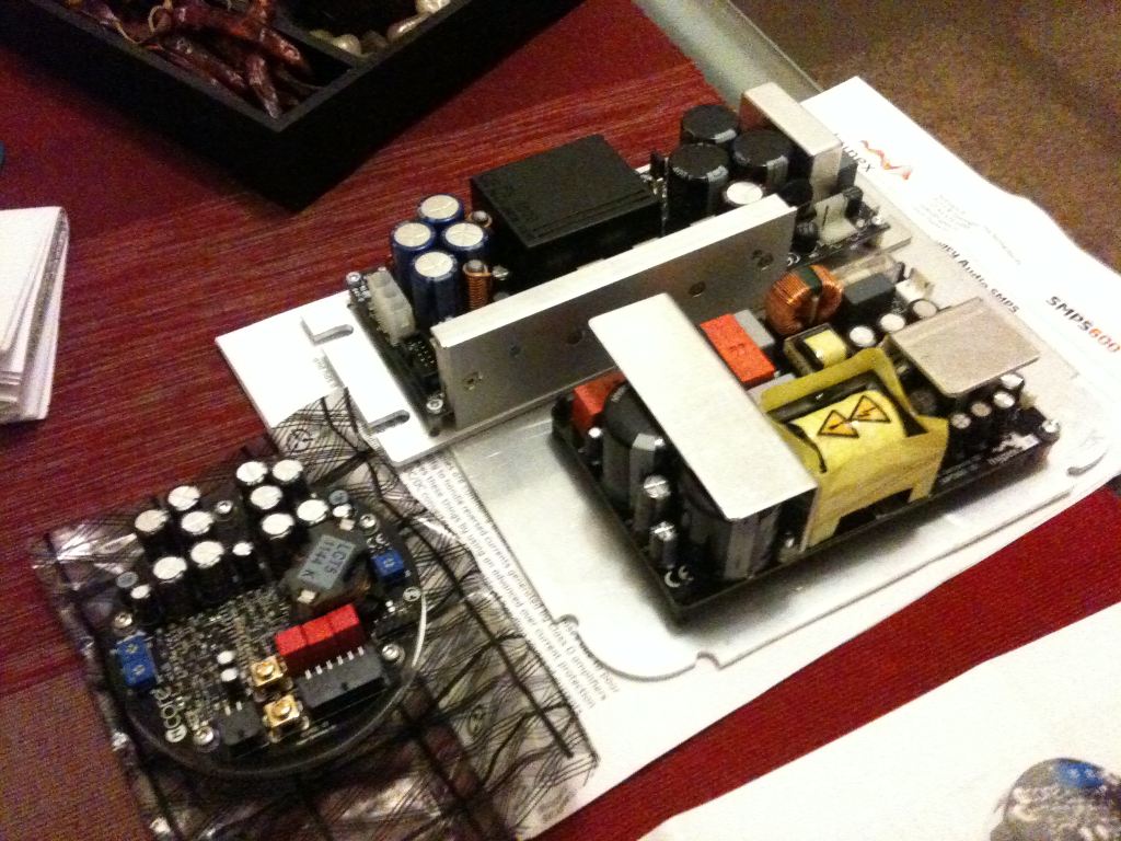

+1Has been noted here before, the SMPS600 for the nC400 amp modules is not a regulated supply: it's output voltage will vary with the variances of the incoming line voltage.
I wanted to mention that but I forgot.
this has been stated many times by Bruno but I'll help people not use the search function again: the published measurements of the NCORE are with the SMPS600. I really think that major problems would not hide in a THD plot.
it looks like some *think* that regulation is inherently good, the designer of the SMSP600 *thinks* otherwise. a declared subjectivist should not think a power supply is better simply because it is regulated, without listening to it first, no?
We have to be a little technical here.it looks like some *think* that regulation is inherently good
A regulated PSU can be a servo , when the voltage is sensed at the output of it.(closed loop). This help to reduce noise, but, depending on the stability ans speed of the loop, can have negative effects too, like overshoot, recovery time, slow responding times. and effects can be very different depending on the common mode and ripple rejection of an amp.
Switching SMPS frequencies can affect an amp with little rejection at hight frequencies, and they will behave better with 50/60Hz, but they can be be sensible to EMI pollution etc...
I never use any more that king of regulation, i prefer to use that kind of stabilization:
www.esperado.fr - Alimentation Crescendo
No negative effect of feedback loops, enough rejection and voltage stabilization, as well as a nice rejection of noise (depending of the type of reference voltage you use). Always better results than simple linear PSU in my analog amps.
Easy to add to a SMPS to see if any improvement in the listening experience with class D amps, playng too with caps values and qualities.

Hi,We have to be a little technical here.
just because it seems to me the correct answer.
Your scheme works of course, you can also bypass the active circuit and introduce a "R", given that you have large capacitors, as "CRC" filters. the dynamic performance, do not change. 🙂
It is not easy to obtain (in the case of regulated), that all parameters are good as: EMI-RFI-Reset time (this is the time to balance the output voltage), and stabilization vs.AC-input, vs.output load,especially dynamically.
therefore, we can not say that a psu has "defects feedback loop", but it depends if you have been able to develop it.

About the fully regulated smps comment. I am wondering how feasible it would be to design a high current fully regulated power supply. Usually regulators have around 0.5-1.5A current capacity. You can have several for higher current capacity, tho.
However, wouldn't it be smarter, instead of designing a general purpose high current power supply, design the module and the power supply so that they work together as good as possible (like in case of smps600 and nCore) to make things easier for the future, if for instance higher current levels are needed. And then regulate things in the module side if/when needed.
That would be designing a platform folks, not just making one product work. I can appreciate that.

The complication here is to get good current sharing between the active devices; we're back to the emitter ballasting "problem", which means compromising output impedance, unless "cleverer" ways are used ...Not a real problem, both for linear or switched ones. Just paralleling parts if not enough current in one power switching/balast device.
Frank
Right, but, for a stabilized PSU, you can both pair the power transistors and degenerate them.The complication here is to get good current sharing between the active devices; we're back to the emitter ballasting "problem", which means compromising output impedance, unless "cleverer" ways are used ...
As it is a closed loop, the internal impedance is achieved by feedback. After all, a PSU is just a classical amplifier, witch amplify in current a static voltage reference, can be low high power low Z.
For Ballast, the output caps are here to minimize impedance. It is just a cleaned linear PSU.
