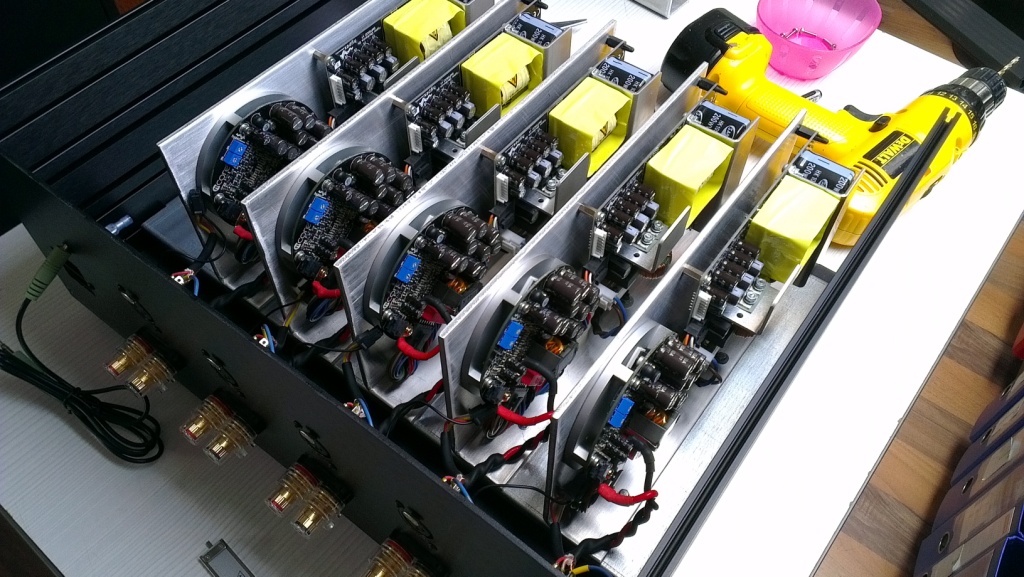

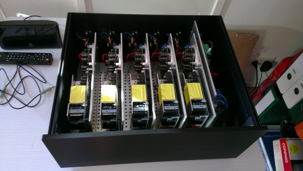

I didn't try an analoge power supply. I have simply no reason to. I have build 5 nCores in 1 case, multichannel. Just nothing to complain about. No hum, no interference, just... music!
