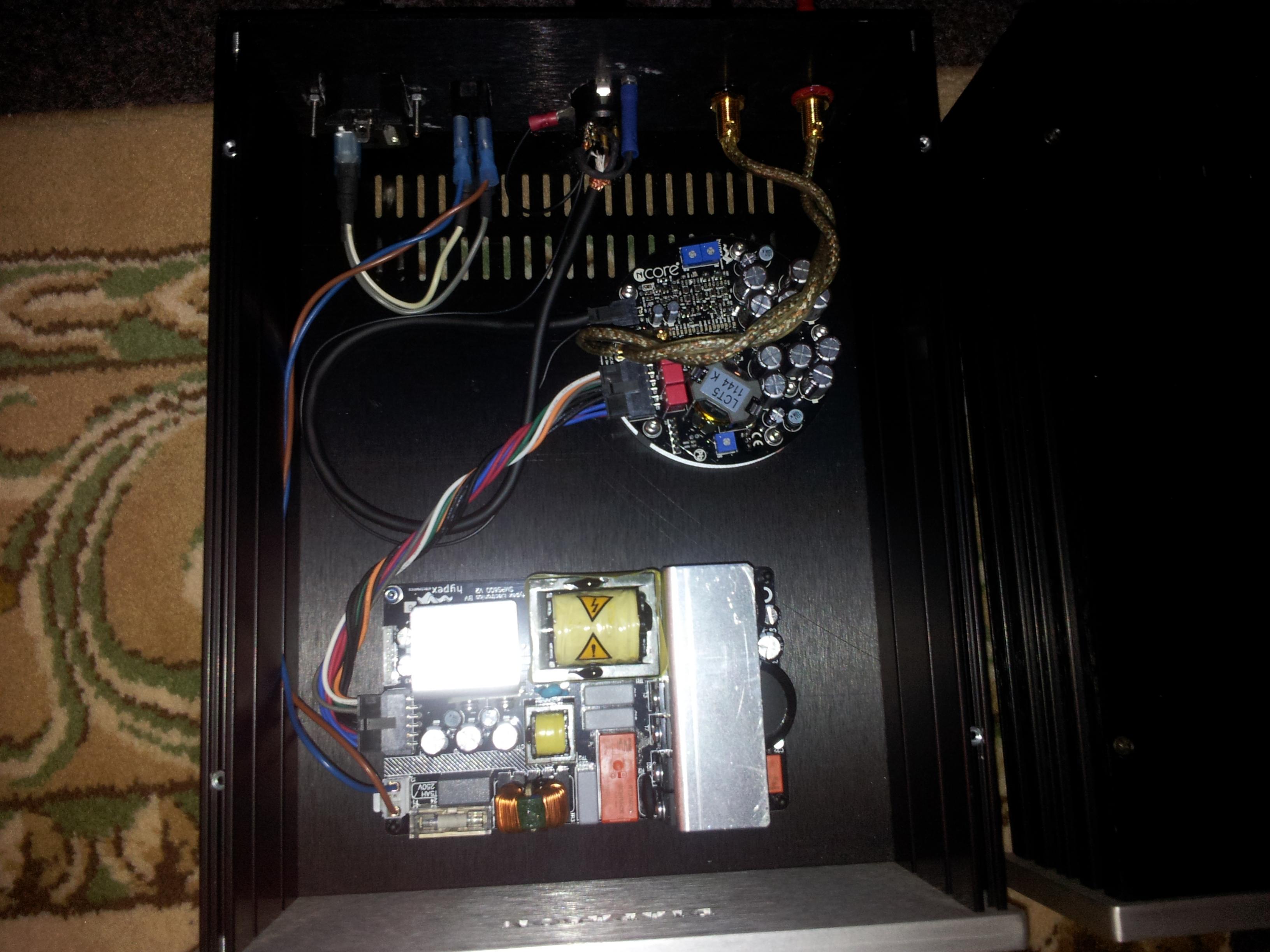

I did use the balanced connection like in figure 2 except for the ground connection, I did actually connect the IEC ground to the chassis.
I don't have ANY hum at all (perhaps due to my source having balanced output transformers), can there be any other sonic improvement if I remove the ground connection to the IEC connector?
from section 12.3.1
"No safety earth connection was depicted. This is entirely acceptable if class II construction is used
throughout. Otherwise, connect the safety earth."
Connecting the mains earth gives an additional noise path - which doesn't mean that there will inherently be noise waiting to go down that path

O.K. thanks, I'd better open the casings soon. I also can fit the new input cable at the same time.
