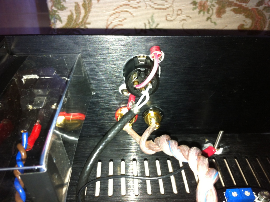

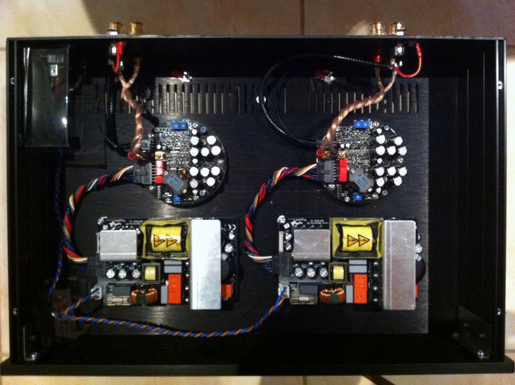

Finally assembled my dual mono nCore.
Is my wiring correct?
XLR pin 1 to ground of chassis
XLR pin 2 to blue wire of input cable
XLR pin 3 to white wire of input cable
Ground of chassis to shield/sheath of input cable.
All AC input, SMPS600 power supply harness and speaker output cable twisted.
I used a bottom mounted on/off switch, located at the front left of the chassis.
PS. Sorry the flash overexposed the colour of the blue/white wires of the Mogami/QuietConduit input cable so they both appear white.

The casework may not have good continuity from rear panel to bottom panel. I use Hifi2000 cases and found they need a cable link between panels for a good ground.
Also you should have mains cables double insulated if no earth connection.
I assume the speaker terminals are isolated from the back panel(?)
I will look into that, and check the continuity with my multimeter.
Yes, I was planning to do that. Then I figured that the anodized surface is non conductive, so I only placed an insulating layer over the top of the AC input terminals to keep prying fingers off.Also you should have mains cables double insulated if no earth connection.
Yes, by intrinsic design of the speaker terminals.
