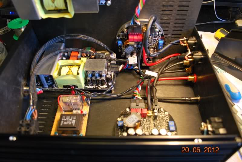

I'm hearing a slight hum from mine. Is this normal?
attachment.php
No. They should be dead quiet. Mine are. Both in their cabinet as they are currently, as when they were "naked" on the table.
- Try with source connected and disconnected. Is the hum in the source?
- check all solder connections on the XLR and input cables
- check whether there's no litze spilling from the speaker/output terminals on the nCore modules
- Is mains earth connected to chassis? --> Don't
- Is XLR connector pin 1 connected to chassis? --> Do (and make sure, as tony mentions above, that contact is actually good)
- Using a Y-cap AC conditioner? --> Don't
This has all been discussed before (do a search, you don;t want to go reading 5000 posts... ;))
For the rest, just make sure you follow wiring guidelines from the datasheet on Hypex' site, nothing to it. Keep power & signal lines separated, keep output wires away from the coils, twist everything except Mogami input cable and you should be good to go.
