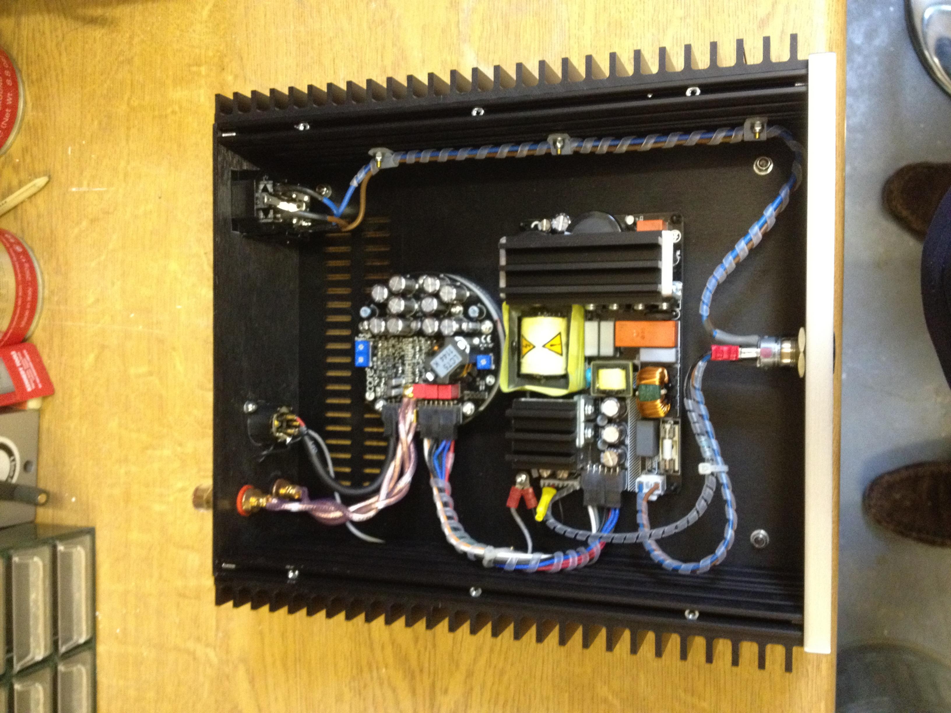

There has been much talk lately about the heat produced by the SMPS600 module. My amplifiers are kept inside a closed cabinet so I have been concerned about safety/long term reliability. With this in mind I have just fitted heatsinks down the sides of my modu2000 aluminium enclosure. As these were too long, I have machined them down to length and used the offcuts as heatsinks for the smps. I have bonded them in place with thermally conductive glue.
Both amps were working perfectly prior to this mod, and have been working glitch free for several weeks. Following the mod, one of the amps will no longer power up. The relay no longer switches over after the initial 2 or 3 second pause. The other amp works perfectly.
Both amps are identical - same wire lengths, positions etc.
None of the heatsinks contacts any of the case work but I can now measure 120v on anything connected to ground (my incoming mains is 240v). I have been over everything for hours with a magnifying glass, thinking I must have caused a short somewhere but I can find nothing. I have checked every single connection but I cant find anything wrong.
I am not an electronics whizz but I did build up these units with great care and attention. I am hoping that someone can point me in the right direction. With the case work now live, I am concerened that I will have fried the ncore too. I have emailed Hypex too but have not yet received a reply.

How much distance between the bottom of the SMPS600 and the case do you have? Should be 6mm or insulated if less.
A live chassis is not fun. Take care.

The SMPS600 is mounted on stand-offs, and it's hot parts do not make contact with the chassis, so the extra heatsinks are of very little value to remove the heat of the power supply.
The original case should be sufficient to dissipate the heat of the Ncore module.
As your amplifier is in a closed cabinet you should improve air flow.
As Ian suggested make some openings in the ground plate to improve convection.
A slow (and inaudible as it's inside the cabinet)) fan might be a better approach to get rid off excessive heat.
Good luck with solving the electrical problem.
What are you using as a reference point for your measurement?
You say you measure 120 V between ground and ... what?

It means that there is a insulation between dangoerous voltages and metal case. Which is not the case if you just mount the SMPS on a metal floor
If you enclose the SMPS in a case, and the SMPS is mounted using the supplied spacers, the dangerous voltages are isolated from the case. Note how the fourth, conductive, spacer is outside the red area in picture at the bottom of page 3 of the data sheet.
Of course it is insulated, otherwise you'd get shocked everytime you touch it. 😉
However - as far as I know it is not sufficient to have 10 mm clearing between metal case and hazardous voltage to meet class II requirements. That's class I. Might be wrong, though. Bruno will certainly comment.

Checking class I and II requirements I don't find anything on distance clearing.
Class I: safety by connection to earth (ground);
Class II: no connection to earth (ground) but double insulation of voltage carrying parts.
The datasheet of the SMPS600 is very clear: use the 10 mm spacers to get at least 6 mm clearance; when using shorter spacers (having the power supply fitted in a 1U enclosure) apply an additional layer of insulation between SMPS600 and chassis .
What's the problem??
Pieter,
There is no problem. Again, as far as I know:
In order to build something with a metal case that is not immediatly deadly you need an insulation. That - for instance - can be >=6mm clearing. If you're getting below 6mm you need additional insulation. However, it's still class I and you need to connect saftey earth.
If you want to build something with a metal case that meets class II (thus, doesn't need saftey earth) you need a double insulation. E.g. a seamless plastic housing around your metal housing. This is normally used for handheld tools like hair dryers etc..
A good example for why this is so is Simtu. What he is measuring could be deadly. His picture looks like he has no saftey earth connected. It is not unusual that there is some potential between ground/earth, if there really was a significant current flowing the earth leakage circuit breaker would tell him.

This afternoon, I swapped the two SMPS's around without changing anything else, and hey presto the other amplifier works again. The problem must be somewhere on the smps board although I can see nothing visual to suggest a short - the problem must presumably come down to a component failure. The question is why would this occur at the same time that I glued a couple of heatsinks in place? Can anybody hazard a guess where the fault may lie? To reiterate, I have been over the entire circuit board and there is no foreign matter anywhere and nor is there any obvious sign of discolouration/burning etc. Would the failure of any particular component result in a short to ground (presumably via the conducting corner stand off)?
I would love to avoid the expense and hassle of returning the faulty SMPS to Hypex so would welcome any and all further advice. Thanks in advance
If the amp is now working after you have swapped SMPS boards it could be that your problem is associated with the interconnect cable.
Check the suspect amp interconnect at the SMPS end and ensure all the pins are fully home into the plastic connector. The pins are crimped onto the cable and unlikely to be problematic. After wiring, the pins themselves are inserted into the plastic connector and held in position by two small metal wings in the pin mating with shelves in the connector. If the pins are accidentally twisted through 90 deg this holding arrangement can fail leaving the pin loose in the connector and not mating correctly with the associated socket on the SMPS plug.
