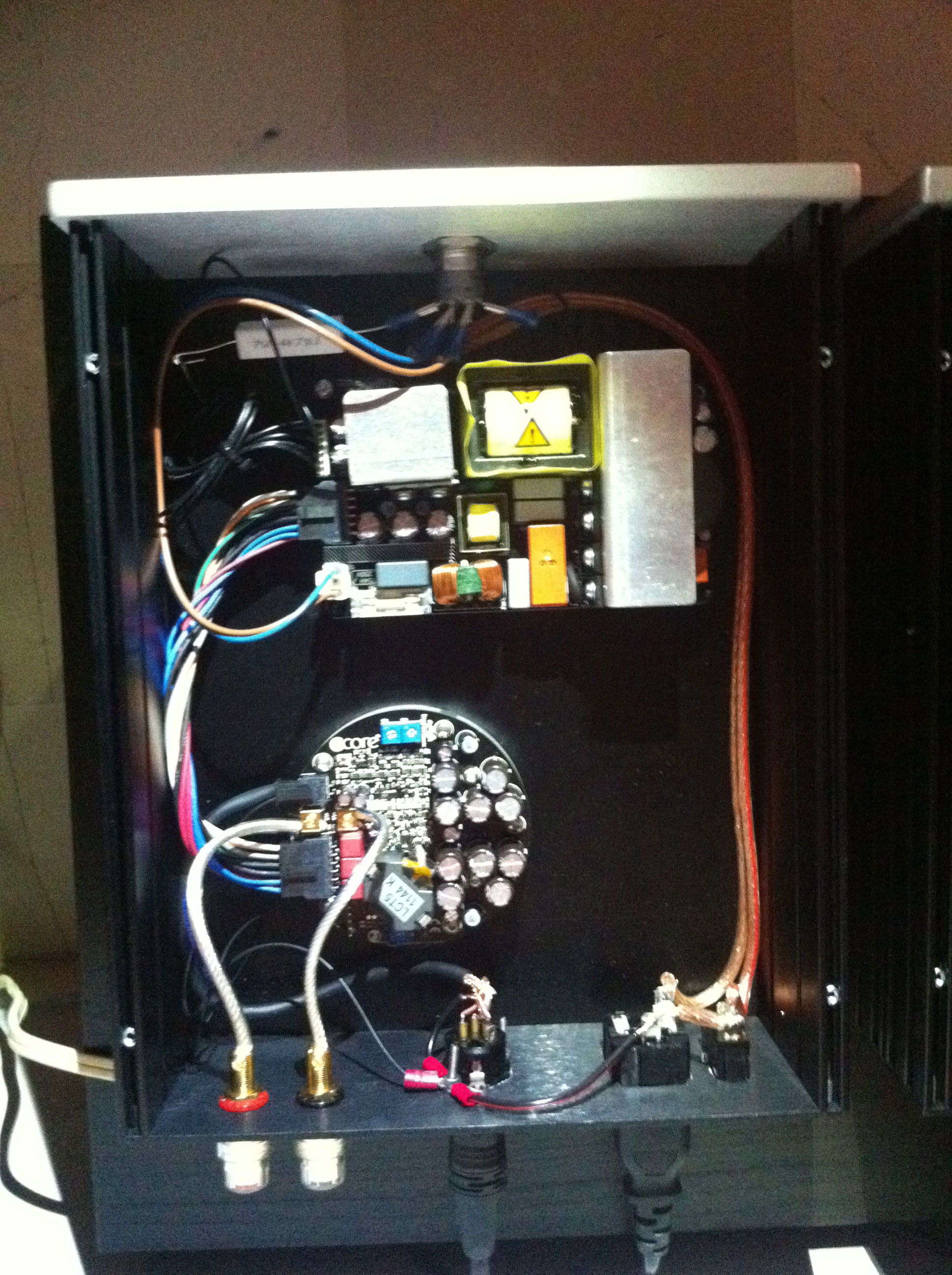

Finally i got my Ncore's and i just put the amp together....but....
I just got a little thiny fizzy sound
. I really tried to connect everything as mentioned in the manual but something must be wrong and i could not found out what it is. Could somebody have a look on the pictures? (i tried the searchfunction but i did not found anything that could help me!)

Do all the red LED's light up on the NC400 modules?
you mean because he doesn't have the Nampon wires grounded?
the black wires that are floating in the pictures need to be attached to ground to take the amp out of standby mode, RTFM.
Also get all that extra AC cable out of there and off the SMPS heatsink. it however is not the problem you have right now. Never attach a piece of plastic to a heat sink, especially when that plastic is holding your AC!

Yes the red LEDS light up. The small black wires are connected normaly to the ground - (white plastic with the yellow earth/wire-but not on the picture!).
Alan, I will change the layout again, but it has to work first. Thanks for your advise!
As i said before i can hear the music out from the loudspeaker but it sounds very low, thiny and fuzzy ... and i can hear the music also from the amp!!!....strange! Any idea??😕

It may look like your speaker connectors are NOT insultated from the chassis? This will mean you have a short-circuit of the amp output, and very little sound .....
I can´t see the speaker wires being properly connected in the pictures (only one channel in one picture).
Are the pics from during assembly or showing the current setup?

IT WORKS!!!!! you had right...it was the speaker connectors. What a sound...! Thanks a lot!!

Thanks Alan, I will try that tomorrow. Please excuse my ignorance, but what do you mean "..with opposite leg"?
here is the proper way:
do twist the speaker wiring and PLEASE do not have them come out of the opposing sides of the screw lugs. This makes a big pickup loop right next to the output inductor.
