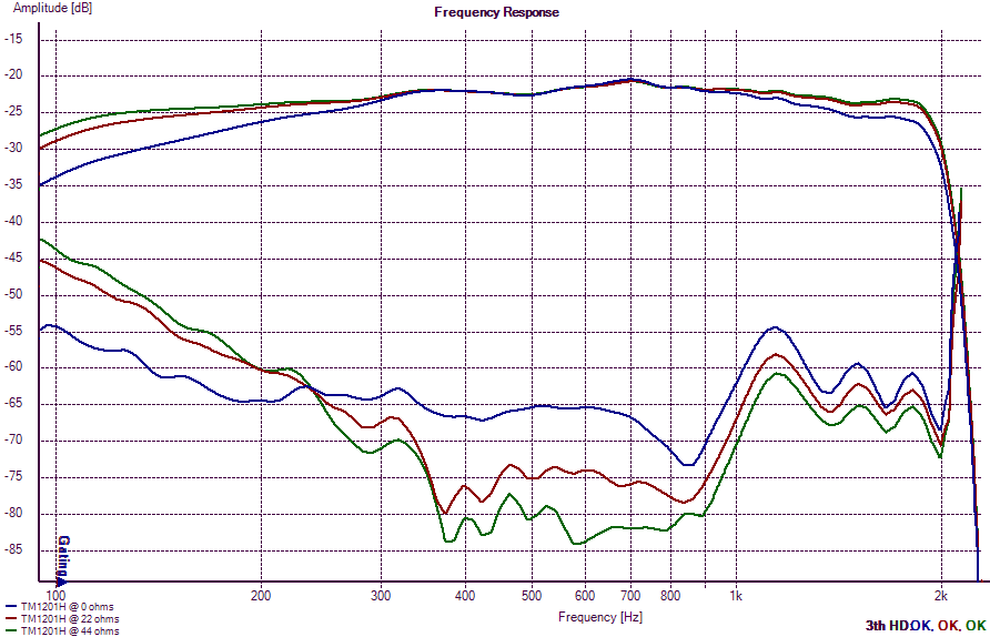

I have had very good reults in distortion reduction with a 44 ohms output impedance on a 16 ohms driver:
http://www.diyaudio.com/forums/vendors-bazaar/190434-hypex-ncore-403.html#post3026510
even 22 ohms already gives good results
