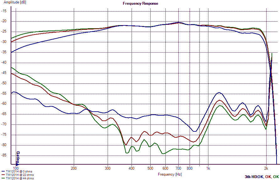

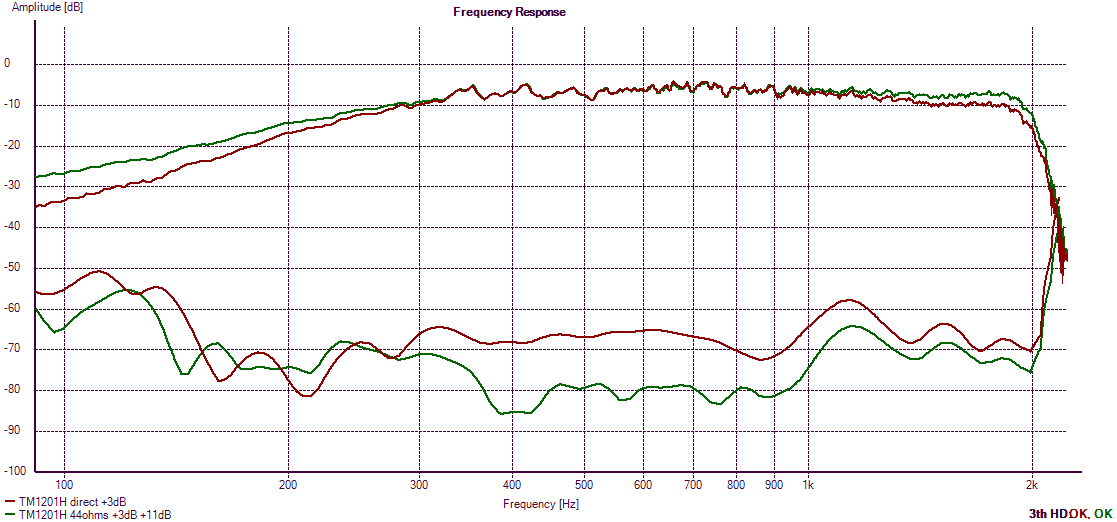

I have done a lot a tests with a simple resistor inline with my amplifier (you can simulate that with WinISD Pro). The higher the resistor compared to the load, the closer you are from pure current drive (but of course the more power you are burning into the resistor...).
Concerning the way current drive modify the frequency response in my experience it really depends on the impedance plot of the driver. So you typically get a "boost" in the lower frequencies (when approaching resonance) and in the upper range if the driver has its impedance rising (which is no more the case with modern motors sporting shorting rings).
I found the benefits were great for a mid woofer (use above resonance) but not so for a woofer (electrical damping has its benefits) and compressions drivers (no distortion reduction).

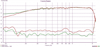

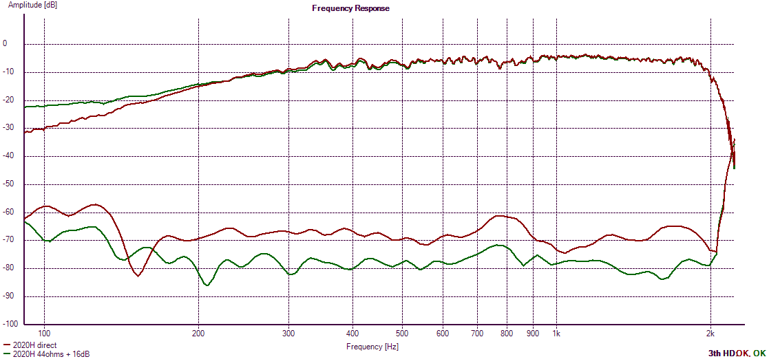

Here are two measurements with a modern midwoofer JBL 2020H, and a somewhat older design TAD TM1201H (older but better due to its great cone), measured in a ~50L closed box with and without a 44ohms resistor. The distortion shown here is 3rd order.
As you can see the JBL is more "stable" in its upper range, because its impedance does not rise as much.
The TAD also has more distortion in the low frequency that is not reduced by current drive (it is even increased, but it is only the effect of the boost: eq it and the distortion is the same), due to its small xmax.
The benefits for distortion are obvious.
