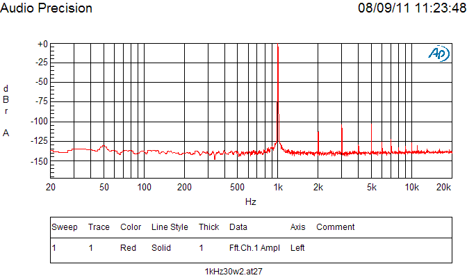

Hi,Someone asked for an FFT at 30W (i.e. roughly the first maximum THD point) earlier on in the thread. I didn't notch out the fundamental because I wanted any mains related AM components to remain visible (if there had been any).
Thank, I'm one that have asked you, fft @30w.

Why does the FFT graph you have posted represent " roughly the first maximum THD point"

The measurement was 30W into 4 ohms, as always done with the SMPS1200. Input impedance of the amp is 200k, output impedance of the AP is switchable and makes no difference.Hi,
Even in this case, i not have condition of test, (R,PSU and input impendance).
There are no harmonics visible above 20kHz. There's only so much you can do with 140dB. I'd have to do synchronous averaging to narrow the bin width further artificially.May be best if extend fft up to f0/10
One measurement tells it all? An FFT of a sine wave says nothing about frequency response, THD at other frequencies or output impedance. Also, it says little about the PSU. An amplifier with bad PSRR on a regulated supply and an amplifier with good PSRR on an unregulated supply post equally clean FFTs. The SMPS1200 is unregulated and is roughly equivalent to a transformer with 6000uF storage caps.I am convinced that a fft, says it all on the amp will sound like. 🙂

The value of 30W was chosen by Roberto and I surmise he did so because the THD vs power graph has two bumps of which 30W is roughly the first i.e. the one most relevant at normal listening levels.Why does the FFT graph you have posted represent " roughly the first maximum THD point"

I disagree that you do not see anything from an FFT. I see a lot and will understand what kind of sound amplifier, independent of the frequency response or the response to the load. (these do not generate a bad sound).
example, in this FFT seen some things that you saw in the previous measures (and is only 30w)

Linguistic mishap 🙂 I didn't say you don't see anything in the FFT, I only mentioned a number of things you don't see in the FFT, in response to "says it all on the amp will sound like" (which you probably didn't mean as absolutely as it sounds).
The FFT plot shows no mains related components at all. Where do you spot ripple?

Just a flat from 10 to 500Hz. you have special filter? or smps is absolute clean in this segment?
Ri-ight... So from the lack of ripple in the output you conclude that supply ripple is 5mV. That would be an impressive feat of deduction, if it were even remotely close. For your information, at 30W/4 ohm I measure a 400mV peak/peak 100Hz sawtooth with another 400mVpp 1kHz sinewave superimposed on it. What you are seeing is an amplifier that has very good PSRR, combined with an unregulated SMPS.
I think that is normal my deduction, if you have-128dB at 100Hz (with 30w on 0dB). However, your 400mVpp at 100Hz, why are not seen on the FFT? Also, your SMPS have not harmonic?
It makes no sense, I think, see an FFT that does not say how things are. and I think that just in case of class D with the SMPS, which recommends, should be shown a fft least up to 50Khz. (or not show)

I think (in terms of 50Hz artefacts) the fft says exactly how things are - as Bruno said:However, your 400mVpp at 100Hz, why are not seen on the FFT? Also, your SMPS have not harmonic?
Roberto you might have to live with the fact that this amp's PSRR simply is as good as the measurement suggests. Period.

But in this FFT, segment 10 to 500Hz is absolute flat (at noise level). if you want that I agree, ...i not agree.

(slightly miffed now) Well, Roberto, if you do not agree, please propose an explanation of your own. Preferably one that doesn't assume sleight of hand on my part. I mean, with all due respect, there might just be the slightest chance that I understand the teensiest smidgen more than you how my own amps work. In fact I would humbly submit that my results appear to suggest that in absolute terms I know rather well what I'm about. This in turn might explain why I'm not surprised at the plot I posted yesterday. After all, engineering is knowing exactly what you're going to get and doing something else if that isn't what you wanted. There's no black art involved. Neither black art nor subterfuge are required to explain my results. Electronics wholly suffices. If you choose not to accept this, that's all the better for me because I only fear competition from folk who understand what I'm doing and hence are capable of doing it themselves.

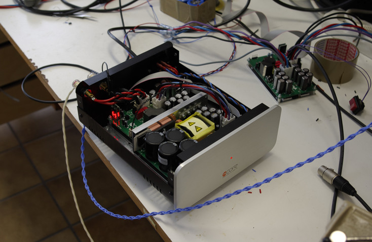

The DUT was still wired up on my bench so here's a picture. It's one of the cute boxes that we send to those selected customers I mentioned earlier. They contain an SMPS1200 and an NC1200. The SMPS is basically rectification + storage + chopper with synchronous secondary rectification. The latter could be of interest.

Bruno that doesn't look cute - it looks damn cute !!!!! Could easily be sold this way (with a top cover of course - for the non technical people out there).

We do ship it with the lid on, but over the years I've learned that uncovered is the natural state for an amplifier.
