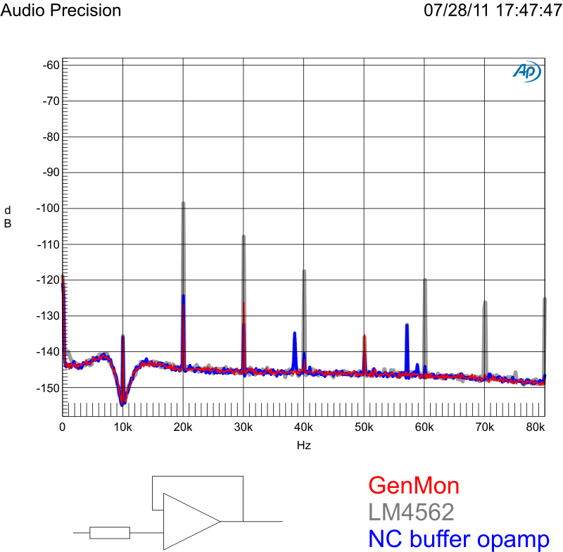

Buffer sorrow
Well it seems the simulation model is mostly, but not entirely right. So it's working stably now, at least the one single discrete op amp that I'm testing first.
The buffer is essentially the good old two-opamp prefix that UcD modules use, except that the op amps are discrete. It's tough. I decided against matched JFETs because any pair of unmatched BJT's has a better offset spec than a matched pair of FETs. Anyhow, low input current doesn't mean that AC input impedance is either high or linear, especially if you're going for low noise FETs. You might be surprised how much a jfet input stage can distort if you don't match the impedances at either input. So, no FETs. BJT's draw base current, which could cause a significant DC error when impedances are mismatched. So my first idea was to use a MAT14 quad. Two for the input pair, a third to generate a current reference to compensate the base current.
Strangely enough, even though I've bootstrapped the input pair I get a fair bit of distortion with unmatched input impedances, nearly as much as what the LM4562 does (which would make discrete pointless imho).
Actually that's something you might want to see in measurement. As Douglas Self pointed out several times, noninverting circuits are most op amps' demise. New "super amps" like the 4562 have stupendously low distortion if you either use them inverting or you match the impedances at both inputs exactly. If you don't, distortion is far from unmeasurable. Look at the attached graph. The spectrum is taken with a 8Vrms 10kHz source (0dBr=8V) through a 3k source impedance. Red is the generator alone. Grey is the LM4562. This is not negligible. All of this distortion is caused by Cob modulation of the input transistors. So actually those of us who prefer passive attenuators are pretty much left in the cold.
With the MAT14 I got a result that was slightly better than the LM4562 but not much. I had started wondering if the input capacitance of that transistor isn't just so high that after bootstrapping you're still looking at a fairly nonlinear capacitance. So I stripped the MAT14 and put an unmatched pair of BC846BW in there instead, which has much, much lower capacitance. Bam, distortion gone (blue plot).
So there we are, with bog standard cheapo transistors and tested under obvious worst case conditions I get distortion which is tons lower than the LM4562 under the same conditions, and probably lower than any other op amp, FET or bipolar. On the one hand my choice to drop FETs is vindicated, on the other hand I'm screwed because I can't use my base current compensation trick anymore. I'll have to find another way of getting round that one. The BC846B isn't particularly low-noise but I suppose the 2SC4117 will be equally fine distortion-wise.
To be continued...
To be continued...
Seems the MAT14 circuit is shackled by the capacitance to substrate. Bootstrapping the substrate caused other problems. I get the impression that it would be a very serious challenge designing a monolithic op amp that doesn't have this problem. Well, three cheers for discrete.
