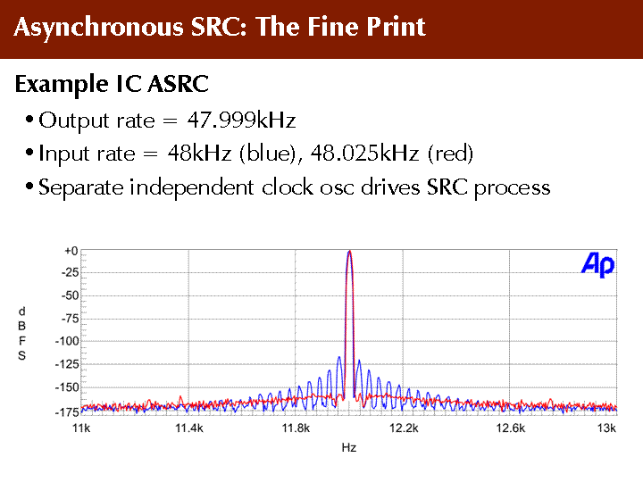

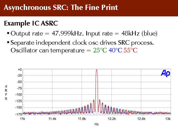

>>edit: I also worry about the SRC on the ESS not being defeatable (if it is the same one I tested 4 years ago it's not that great) but it becomes transparent if you lock all clocks together. The filters are programmable. But I wish they'd made just the back end available directly. Anyhow, if you look at some of the older and cheaper DAC chips, there's some serious performance to be had as well. Just look at the plots in the AD1955 data sheets (and imagine it's made with the rather ramshackle application circuit from the same data sheet and that they actually measure the whole signal instead of just the distortion residual).

Sorry to bore with a question on the ESS dac but you mention that the dac becomes transparent only when all the clocks lock together. What do you mean by this , should the upsampling rate be a multiple of the incoming rate when using the SRC in the chip or are you referring to the PCM filter roll off characteristics.
From their white paper, (Technical Details of the Sabre Audio DAC)
The Sabre DAC rate converter has two advantages compared to the
poly-phase filter approach and is described in great detail in
the pending patent. Firstly the rate conversion is unlimited –
allowing the Sabre to always achieve a conversion into its .
exceptionally high clock rate (as much as 40Mhz) from as
little as 4Khz in one step; and secondly, the process is
essentially perfect to the bit level – the output DNR exceeds
175dB and the THD is correspondingly high.

@Arthur I think it would take us off topic to discuss in detail. ESS's claims regarding the SRC pertain to the actual interpolation process. They have done an absolutely splendid job there. The thing that causes problems is the ratio estimator (the bit that works out exactly what sampling time to interpolate). The bandwidth is too high which lets through time quantization errors. The circuit samples the incoming clock signal using its reference clock. This results in the addition of jitter with a peak-to-peak value of one reference clock period (e.g. 25ns for a 40MHz reference clock). Next the number of ref clock periods in one input clock cycle are counted and this constantly changing number is fed into a low-pass filter which outputs a cleaned-up version of the ratio between the reference and input clocks. This ratio is then used to space the "virtual resampling points" calculated by the interpolator. Of course the low pass filter doesn't output pure DC. The spectrum of the counter output consists of mix products between the two clocks. The filter can only attenuate those. The attenuated spectrum shows up as close-in FM sidebands exactly like jitter. DNR and THD measurements ignore those. The SRC successfully removes high-frequency jitter, thus guaranteeing good SNR, but it adds low-frequency phase modulation of the signal that wasn't even present in the input clock. All SRC's do this but the bandwidth of the low-pass filter determines whether this is an issue or not.
The attached two measurements were made on a standalone test chip for the ESS SRC which was never issued as a product, but the actual SRC did go on to be used in the Sabre DAC.
