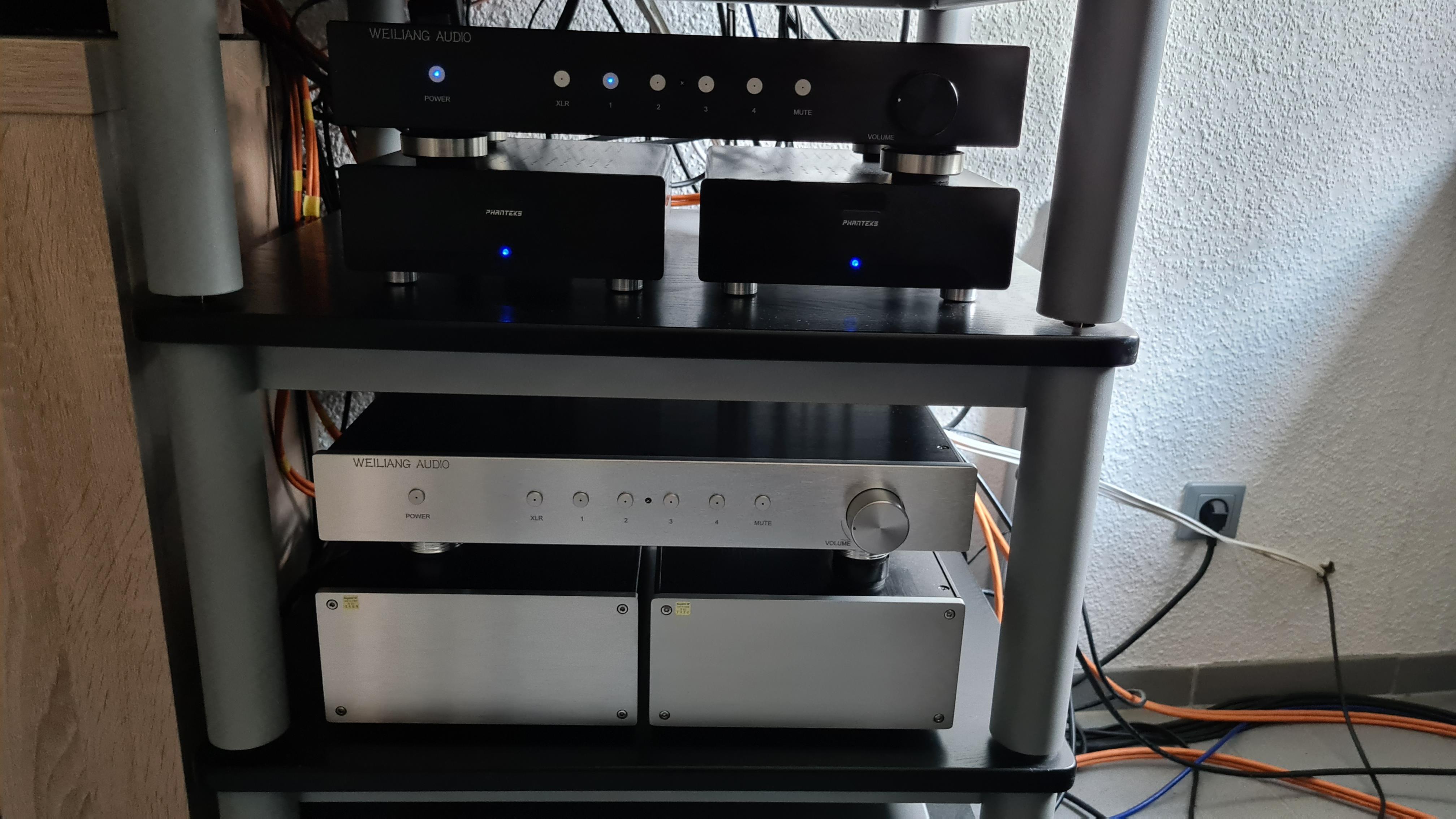

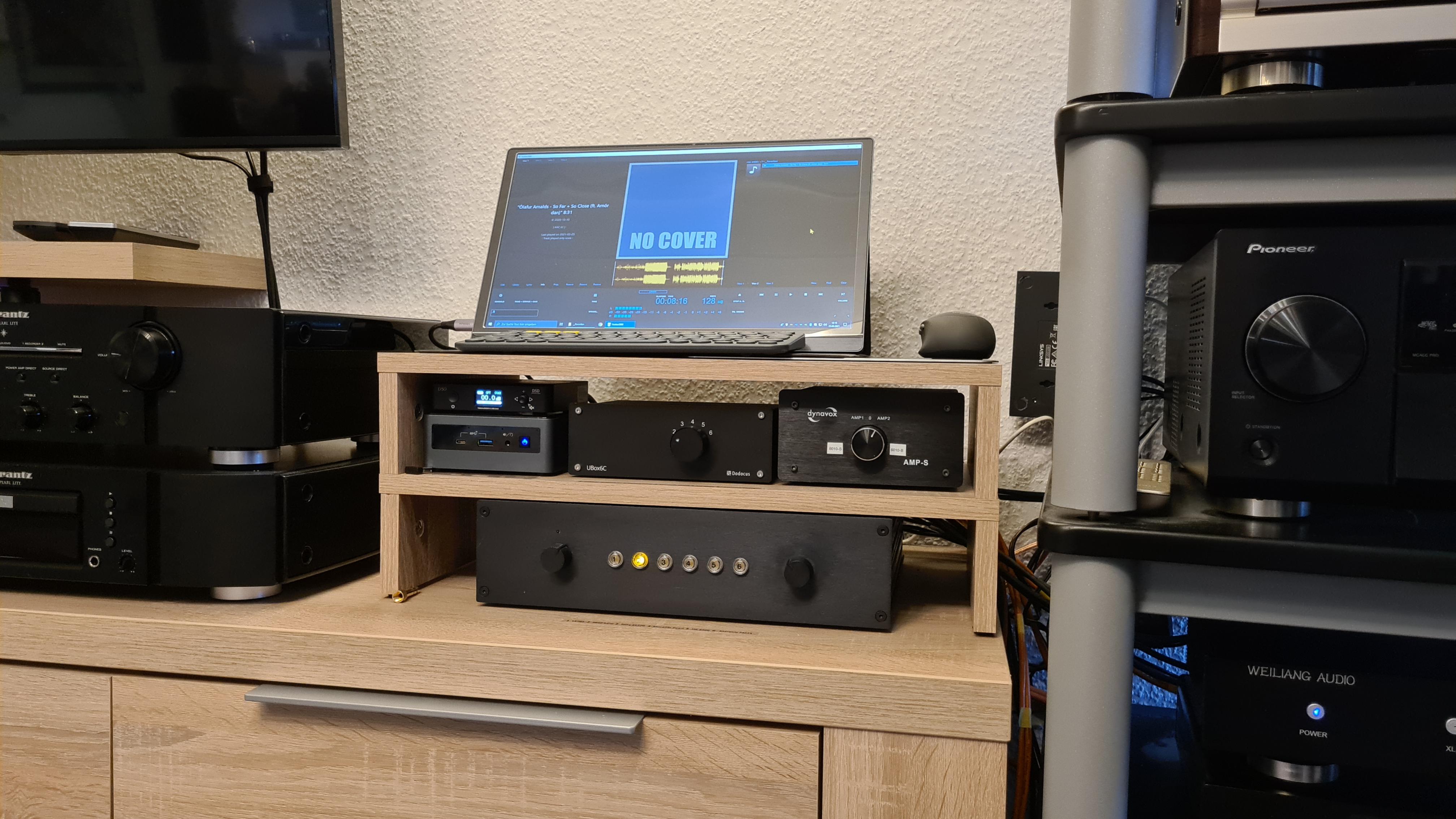

Hi Guys,
i made the effort
to compare again for most of the day,
although I've been doing this for two years.
Version1: Hypex NC400
Preamplifier Weiliang black 6010D Opa, World class clone,
with 10 x Signetics OPA 5534AN and 4 x OPA OPA2228PA Burr Brown
Power amplifiers Hypex Ncore 400
DAC Topping DS50, 32 bit 96000 Hz
Loudspeaker ASW Genius 510, impedance minimum 2.6 ohms
vs.
Version2: Hypex UcD400HG HxR
Power amplifiers Hypex UcD400HG HxR | UcD
In my opinion, the Hypex UcD400HG HxR | sound UcD
rounder and more musical, the Hypex Ncore 400 more precise and precise,
this could be a bit too much in the long run.
With the system in this constellation, I've been hearing for about two years
the Hypex UcD400HG HxR | I just like UcD better.
Nevertheless, I also regularly listen to the NC400,
somehow they are addicting. 😁
Oh,i forgot, Amplifier switch from Start - good-old-hifi
Cinch switch from Dodocus Audio-Umschalter
Happy Easter and big eggs. 😉
HaJott
PS.
The power amps were my only DIY projects,
This will remain so.
Otherwise my focus is on collecting and listening to music.
I also collect old amplifiers and CD players from Harman/Kardon, Sony and Marantz, it's fun too.

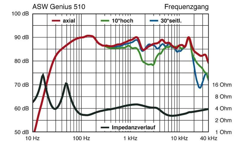

Hi HaJott!
Did you do some correction to the ASW speakers? Seems it's not having very great linearity in the frequency domain in it's original state. Might be that the more revealing ncore amp shows the speaker's weakness? Of course this is just speculation, but perhaps not entirely unfounded.
Hi YSDR,
I looked for more technical data:
Technical specifications:
Crossover: 6/18 dB impedance - linearized
Bass: 2 x 220 mm wood fiber cone / neodymium magnet / 52 mm double-layer titanium voice coil
Midrange: 2 x 150 mm wood fiber membrane / neodymium magnet / 39 mm double-layer titanium voice coil
Tweeter: 25 mm high quality ceramic tweeter dome
Housing: varnished varnish, braced and reinforced inside
Dimensions: height: 1260mm / width: 290 mm / depth: 350 mm (height without spikes)
Nominal load capacity: 250 watts
Impulse load capacity: 300 watts
Frequency response: 28 - 30000 Hz.
Crossover frequencies 150/2000 Hz
Sensitivity 93.4 dB (2.83 V / m)
Connection range: 4 - 8 ohms
Impedance: 4 ohms
Weight: 35.5 kg
Accessories 1 set of Soundcare spikes (included), 1 set of spikes for carpeting (included)
The power amplifiers get along very well with the loudspeakers,
the bass is compact and not blurred,
I hear the only difference in the heights
the NC400 are very "accurate".
I'm actually very happy with both combinations, too
if there are small differences.
Jazz always works with the NC400.
I hope Google translated everything correctly. 🥴
