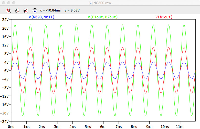

Some pretty outlandish accusations have been made recently which might give concern to purchasers of a Nord NC500 amp with the Hypex recommended buffer circuit including the LM4562. However, once again, Section 11.2 of the NC500 data sheet provides a lot of information useful for those speculating as to the output current required from the necessary buffer (whether using one provided by Hypex according to their recommended design or any other circuit design even if none of the latter have been proposed by anyone thus far). More specifically, it states "use the model of Figure 2 to estimate input current." It takes about five minutes to model this in LTspice. The results are straightforward and conclusive and should provide comfort for those wanting to use the Hypex buffer or the Nord buffer with an IC op amp.
I think (hopefully) we can all agree that the higher the line input voltage the greater the current the buffer needs to supply. So for huge conservatism's sake, let's drive it with a whopping 4Vpeak differential input voltage (2.83Vrms) i.e. 2Vpeak on each input. This implies a swing in the voltage output from each of the op amps to about 10.8V or a swing in the output differential voltage from the buffer to about +/-21.5V. See pic 1. (I don't even need to convert that to SPL at my listening position given my speaker efficiency and listening distance to know I'd quickly go deaf.)

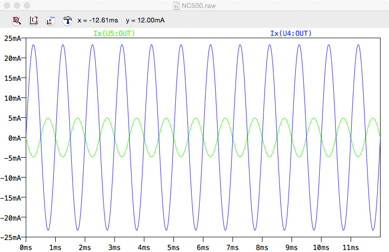

Now, let's look at the output current of each of the two op amps. Pic 2. A glance at the model and it is easy to see that the loads are different for each. But more importantly for those that fear their buffer with an LM4562 or other IC op amp can't provide the output current, we can see that even with this massive input voltage the most demanding current output is 23mA. I guess if you play your NC500 above its absolute maximum all the time you might get concerned the LM4562 is operating at the maximum of its specified range. I wouldn't though. And I wouldn't drive the NC500 to such levels in the first place.
If sonic differences are audible when one changes the IC op amp or deploys a discrete op amp design I don't think it's because the IC op amp is being demanded more current than it can provide.
