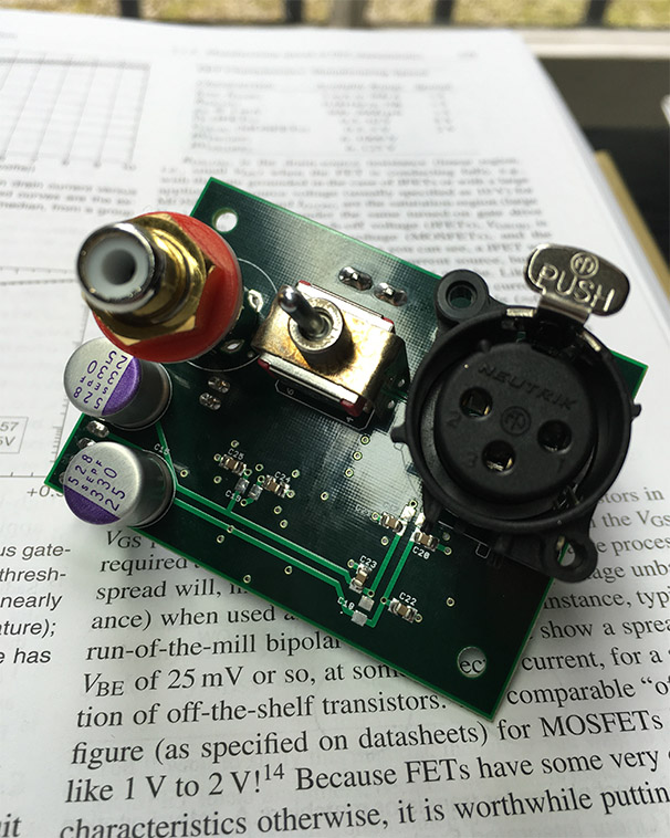

Julf, are you sure the input buffer can't be configured for unity gain?
Shouldn't be hard with the LM4562. It is unity gain stable. Just alter the feedback resistors, ensuring the LM4562 sees the same load.

Indeed. This "basic" schematic of the input buffer is provided in the NC500 data sheet (the minor revisions for Rev C suggested by Richard can be found herein, but don't affect the gain - or noise for that matter) but the evaluation tool factsheet makes it even easier by stating the change explicitly. Potentially R10 and R12 could also be removed and jumpered for lower noise but this requires a little more evaluation to make sure the LM4562 isn't overloaded by the amp stage. (Use the LTspice model I provided.)
BTW just because the LM4562 works well at unity gain doesn't mean all other op amps will.
Bavmike, input buffers aren't hard. Here's a pic of a balanced to single-ended unity gain input buffer I did for an amp I am working on - it uses the equivalent of twelve LM4562 (3 x quad packages). Just for fun. No need for me to post scale-less measurement pics here and further clutter Boggit's thread. You've done that enough already. Suffice to say its noise doesn't rise above the noise floor of the measurement device.

What is the gain of the standard Hypex buffer? Colin's buffer has the same gain?
I'm not fancy of high gain stages, if the preamp already can provide a strong signal. For example, a 20 dB gain buffer would rise the noise floor at its input, a hundred times.
