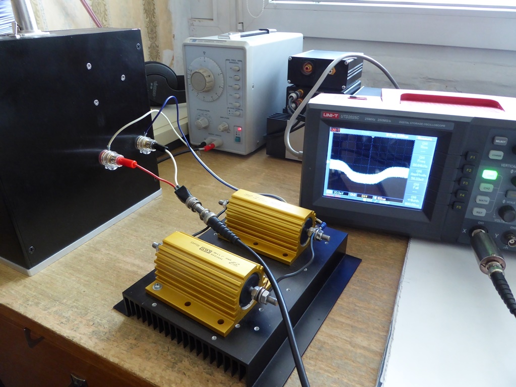

A friend brought me a pair of Hypex Ncore NC400 little amplifiers to make some deeper analysis, based on my measurements. First, I would like to congratulate Bruno and the team to outstanding parameters of this amplifier in the audio frequency band. Very low noise (I measured -95dBV(A) at the output, negligible distortion of all kinds, no hum, no mains spurious components. So far so good. I was thinking about returning the amplifiers to the owner saying I have found nothing special. Then I got an idea to use old-fashioned stand-alone instruments and to make some measurements like long ago in the lab. I have connected an analog 10Hz – 1MHz generator to the input and observed amplifier voltage output shape on the scope screen. Everything fine up to 440kHz. And then it happened – though the input signal was only 21mV, it started to be evident that the amplifier, at least the piece that I have measured, has not designed an input anti-alias low pass filter properly. When the input frequency approaches to Fs (about 460kHz) and 2Fs (about 920kHz), one can see aliases, difference frequencies Fs – Fin (or 2Fs – Fin) appearing at the output of the amplifier. I measured about 56mVp-p output swing of the alias signals, in the audio band. I have put a 2xRC analog low pass filter (27kHz) at the scope input to remove 460 kHz switching frequency of the NC400. So, the input signal containing HF components may, under certain circumstances, create audible alias frequencies at the NC400 output. This is not very good and I guess that a better input anti-alias low pass analog filter would cure the situation.
Attached is my measuring place, the alias signal is stored in the scope memory. Please see analog low pass filter at the scope input to remove/reduce 460kHz switching frequency.

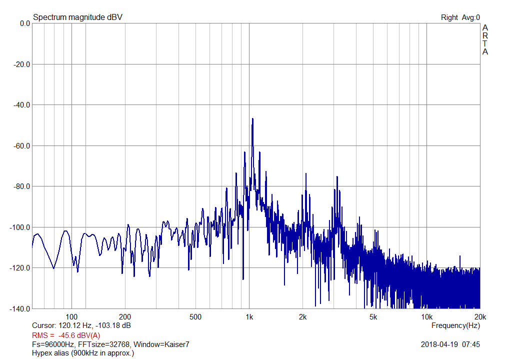

These audible aliased sounds are excited by input level of only several mV. A spectrum of in-audio band alias is attached, input signal was near to 900kHz and input amplitude below 10mV. I am also attaching the recorded sound in a zipped wav file. Full scale level of the recording would be 1V. It sounds exactly like old heterodyne receiver.

A 460KHz input is not very likely from a line level source feeding an Ncore.
In fact, much more sensitive band was around 900kHz, twice the switching frequency of the modulator.
Yes, the input signal like that is not very likely, however, output spectrum of some digital sources is very nasty and contains frequencies "of interest". Only several mV of the "right" frequency signal triggers the occurrence of the alias frequencies. Almost independent on further change of the interference signal level.
Quite simple anti-alias input low pass filter, like double-RC or LC, would probably cure the issue completely.
