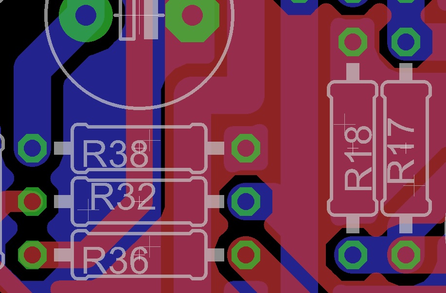

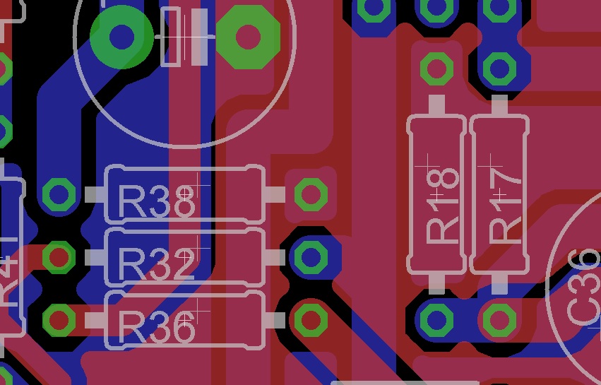

One more tip on smash ( see attachments ) if you right click on the large cross hair of the components name , select "move" and then keep right clicking and move your mouse until the "names" cross hairs are aligned , as I did with R17 and R32 .Gives a very Pro look 😎

SGK, everything is done manually 😱, because I wanted to have the layout as symmetric as possible and to have as wide traces as possible..
