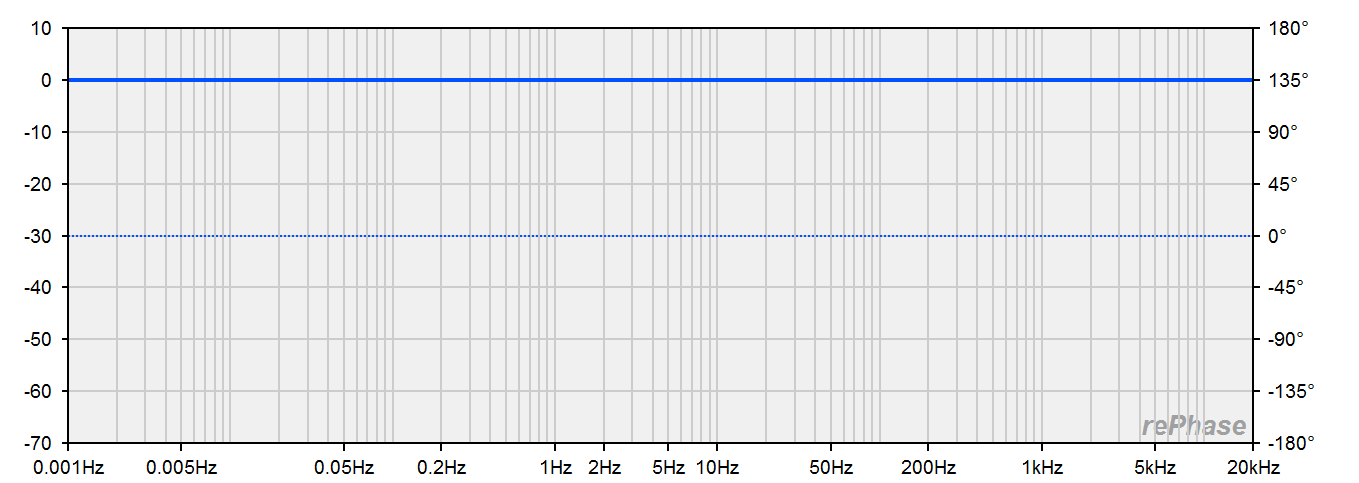

Why does the frequency graph not go down to 0 Hz?
There is no such thing as 0Hz in a log scale 😉
Okay then just 1 then 😛
+1 I have a HP filter @ 5Hz that I cannot edit. Most of IT is not visible in HFD so I have to measure on amp output.
