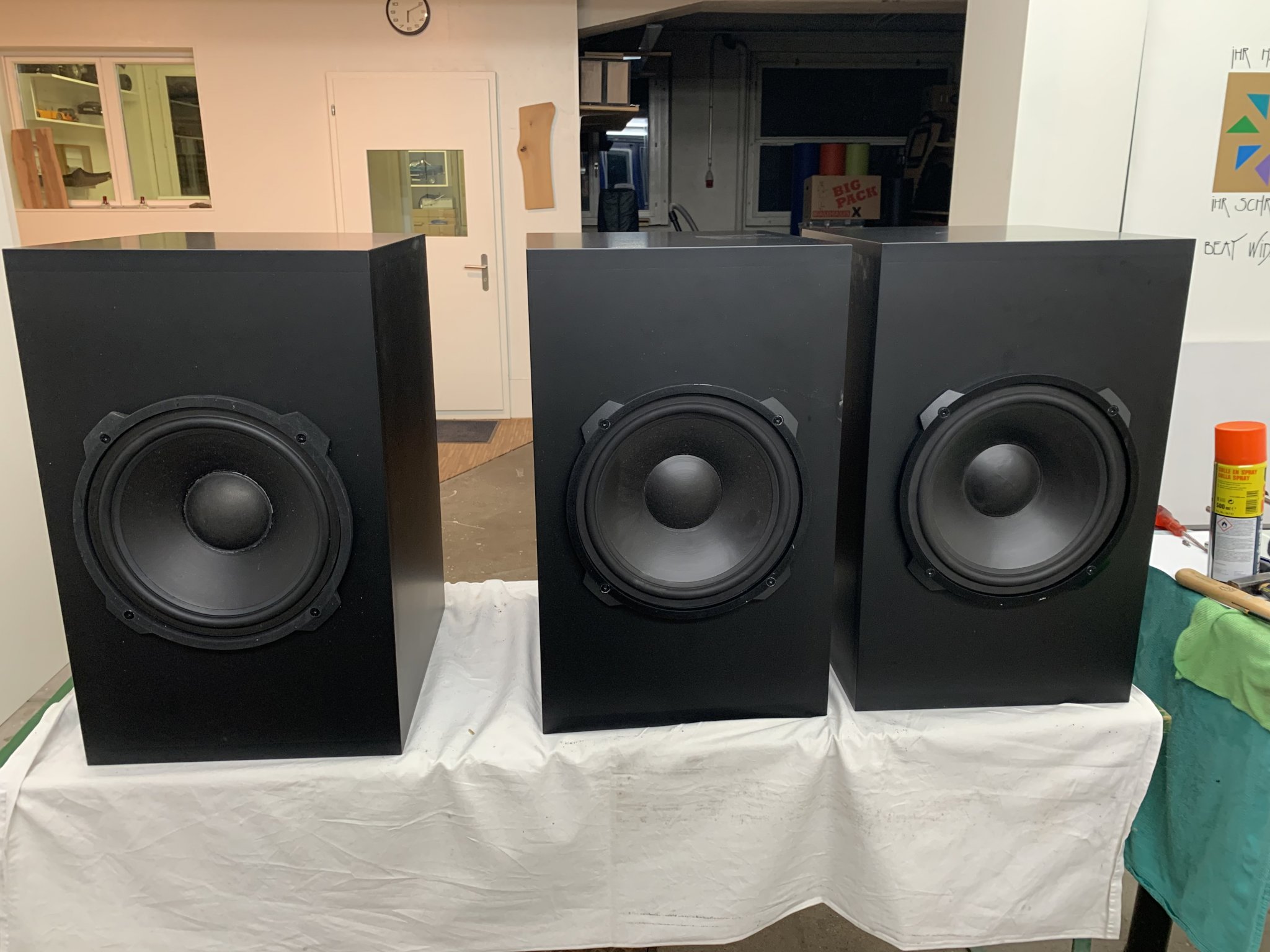

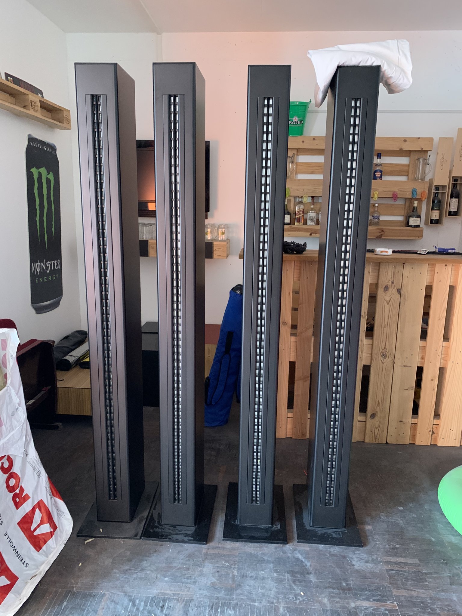

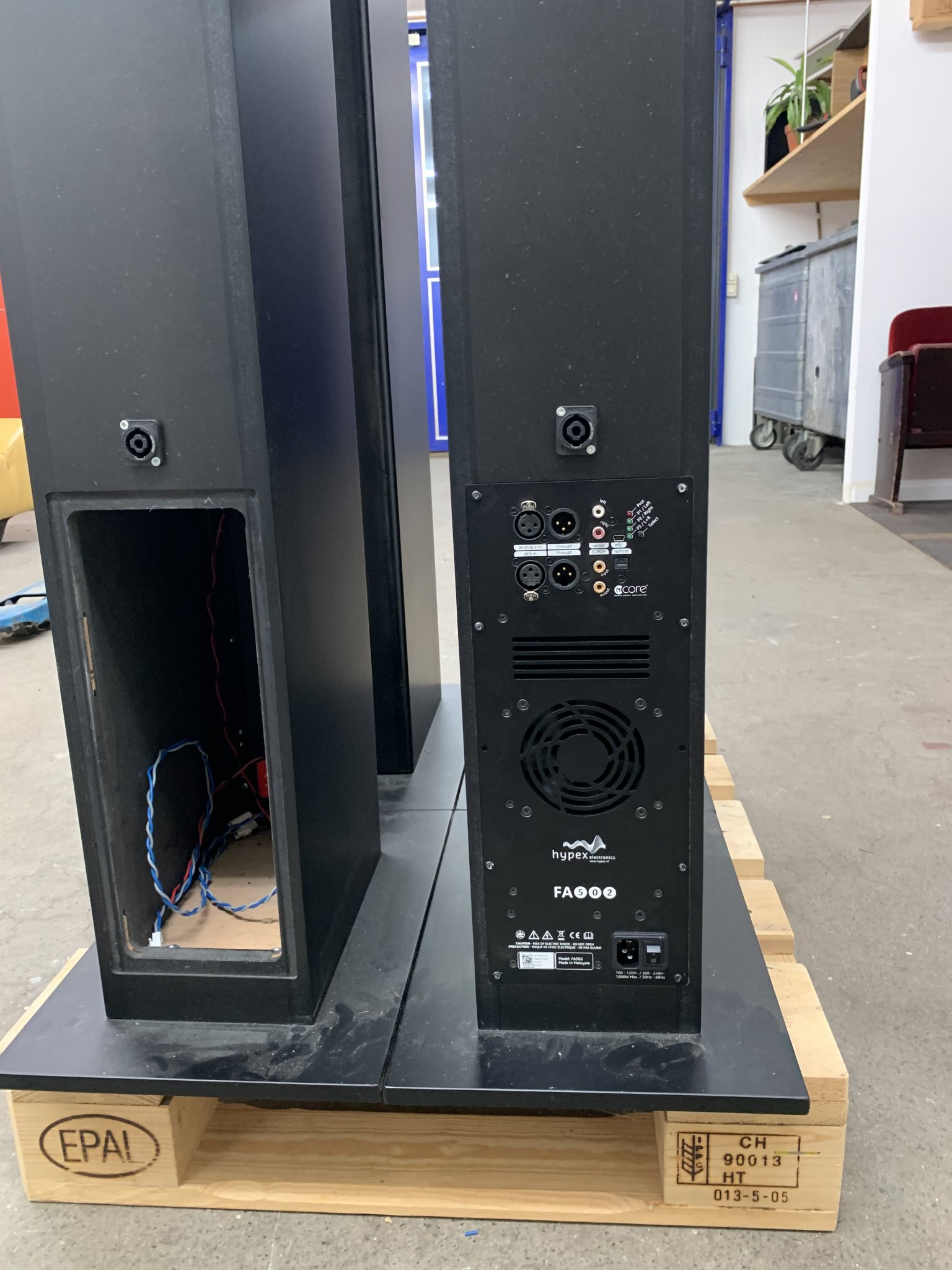

you are back here…. i followed your speaker project with the Rd75 and the openbaffle woofer. I am building right now this ones
