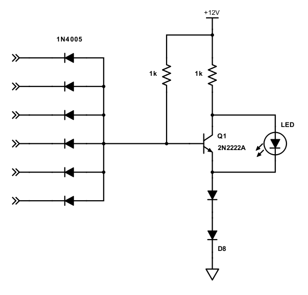

Now the 'Clipping' and 'Current Limiting' circuits. These need different circuits.
- Current Limiting: This light needs to be OFF when NONE of the amps is limiting, but come on when ANY of the amps is limiting, i.e. when any of the 6 Current Limiting pins is LOW. So I think this makes it a NAND circuit. So this means I need a separate pull-up resistor for the transistor base (so it's high by default), and the diodes need to be the other way round, so that the transistor base goes low if any of the input pins goes low.
- Clipping: This works the same way as the Current Limiting circuit. The difference is that these pins are open collectors (not internally pulled up), but since my individual adapter boards will pull them up I think this makes the required circuit identical to the Current Limiting circuit.
Here's a six input nand gate. It may be possible to combine the 4 diodes into just two,
shared between the LED and the transistor.
Here's a reduced version of the NAND gate.

Thank you - I'll add a couple of diodes to the NAND circuits. From our PMs I gather these diodes will raise the voltage on the emitter of the transistor, so that the base is guaranteed to be low enough (compared to the emitter) to turn off the transistor. So those two diodes will cope even when the clipping circuit is at it's worst case of 1V.
Your help is much appreciated.
Here's the schematic with those input resistors removed (I forgot to renumber R19 to R23, but I'll do that before placing an order):
