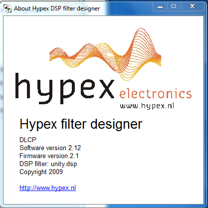

I've updated the firmware to v2.1. I've created a basic configuration with unity filters in each biquad position and downloaded my filter configuration to the DLCP. I've tried analog, USB, S/PDIF and Optical inputs. The DLCP seems to boot and operate correctly. The control board recognizes the DLCP. The Filter Designer v4 connects to the DLCP.

I've added pictures showing the DLCP and it LEDs, the cable connections between the PS-DLCP-Input board and the Filter Designer version. I've reflashed the firmware and created a new config file. Still no audio output. Also, I have tried different sources.

Hi James. I'm seeing that you have the DLCP connected to the host computer and communicating correctly, with firmware updated all the way to V2.3 right? In that case open the control panel in the software where you tell the DLCP which input to use... that control panel. You will see a control for input level, mute and a window displaying the input level value. There is a bug- at least for me- where everything flips out if you slide the slider but if you directly enter the value in the input level window it works. By default it is at -96. Enter 0 there for unity gain and you should now have output.
