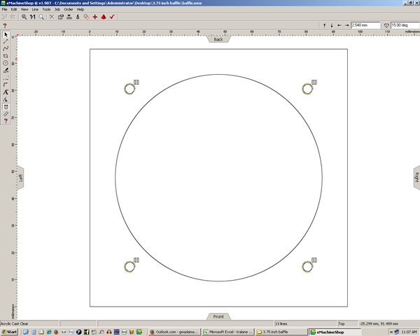

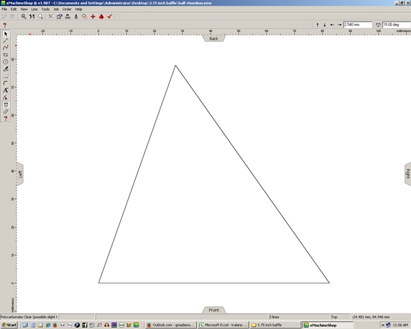

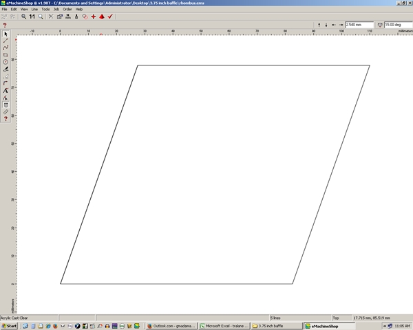

trying to show pictures....never done this before.....
Very cool looking enclosures. What adhesive did you use?
This enclosure style is heavily triangulated, and should have reduced panel resonances and standing waves, as well as pretty decent diffraction characteristics. Also, they are very styley. 🙂 Frankly, I don't buy the hocus pocus either, but despite that I think these are pretty smart cabinets.

I'm curious about that 1.55K resonance. I suspect it's a cabinet panel resonance. I'd like to see if I can model it. You've already said that the box you built has a speaker baffle edge length of 4.25" (the size of the square piece) and is made of acrylic. Please correct me if I have that wrong. What is the thickness of the material used?

Thanks for your inquiries and compliments. My enclosures are made of 6mm acrylic bonded with weldon #4. I don't personally believe there is any hocus-pocus going on here (my measurements seem to agree with my ears) but I've been fortunate enough to actually experience using these things and since I have had such a good musical experience with them, I suppose I'm biased now. I'm sure the diffraction characteristics are improved with respect to a rectangular box, but I don't know exactly how much that plays into the measured/observed sound. What the measurements don't show (at least yet) is that the panels seem to resonate over a wide frequency range. I feel it when holding the speaker during play. My measurements were made with the microphone ~2" from the driver (closer than the pictures show) and ~41" from the floor/wall/ceiling. I'm happy to provide as much information as possible so please let me know if there are other measurements I should attempt. --Greg
