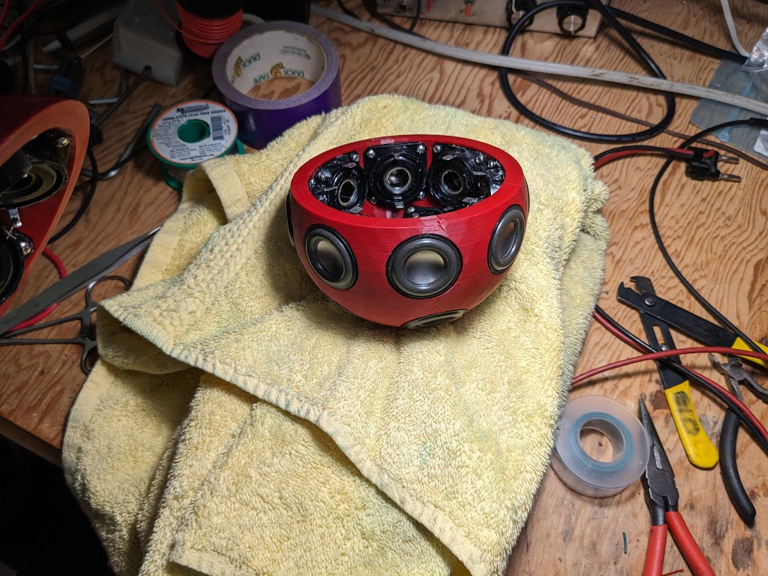

Do you have a link to what you've built there? is this an omnidirectional sound source?Also 3d printing. I regret wasting years trying to get good results from $500 printers made with cheap bearings and ball screws before finally buying a Prusa with accurate drive and the best Japanese bearings that actually last more than 100 hours.
How to build a spherical speaker <-- Here's a link to the posts I made on this design. Yes it is an omnidirectional speaker. With three channels of amplification and digital crossovers for each sphere they can be run as a point source, omni-directional, cardioid pattern or omnidirectional. The speakers were purchased shortly after I made them, so I don't have as much documentation as I would like. I used 20 Aurasound Cougar drivers in each 6" diameter sphere with equalization required to get a good response. A 12" woofer was used with each sphere to make a full range system. If you have interest in printing some I could dig up the .stl files.
tktran303 "Do you have a link to what you've built there? is this an omnidirectional sound source?"
