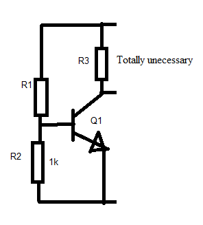

I guess were all in agreement R3 is totally unnecessary and wasteful and doesn't even work the way its assumed to work, please raise your hand if you disagree
It works the same as the good old peaking current source used on ICs. Choose R3 equal to the differential resistance the rest of the circuit would have had without it and the first-order sensitivity of the voltage between the collector and emitter of Q1 on variations of the current disappears. Whether that's a feature you like to have is up to you; if the current is already quite predictable, there is not much point to it.
Wrong guess of yours. I raise my hand and disagree. Could you please elaborate why R3 might be "totally unnecessary"? What is your understanding of R3 in terms of it's assumed function?I guess were all in agreement R3 is totally unnecessary and wasteful and doesn't even work the way its assumed to work, please raise your hand if you disagree
As for my understanding, R3 is indeed not strictly necessary, but it's a cheap, robust and elegant refinement of cicuit functionality. Not strictly necessary means that you also certainly can omit R3. You also can omit a VBE multiplyer altogether and build and run an output stage with two serial diodes as a bias voltage generator if you want. Or take three diodes. Or four diodes. Any of these variants will result in a more or less functional amplifier ...
I would go with a VBE along with a carefully matched R3. R3 matched to IC of the VAS, even in presence of a current source for the VAS. Because no current source is textbook-perfect.
@MarcelvdG, your quite interesting, lets assume a linear transistor is used here, there are even crazier things happening to the output devicesIt works the same as the good old peaking current source used on ICs. Choose R3 equal to the differential resistance the rest of the circuit would have had without it and the first-order sensitivity of the voltage between the collector and emitter of Q1 on variations of the current disappears. Whether that's a feature you like to have is up to you; if the current is already quite predictable, there is not much point to it.

@Daihedz I agree with you its totally unnecessary
In Douglas Self's book which I mentionned in a former post there is a Spice simulation showing the effect of a well matched R3 in case of Ic variations. From the shown graph and varying Ic between 5mA and 7mA:
At R3 = 0 Ohm, the delta for the VBE_multiplier Voltage is 40mV
At R3 = 22 Ohm, the delta for the VBE_multiplier Voltage is 2mV
The 40mV number matches my back-of-the-envelope calculation:In Douglas Self's book which I mentionned in a former post there is a Spice simulation showing the effect of a well matched R3 in case of Ic variations. From the shown graph and varying Ic between 5mA and 7mA:
Code:
(.02585V)/(.005A)*(4 diode drops)*(.002A delta) = .041V delta
@Daihedz, thank you again for reaffirming why its useless, where's variation in Ic coming from look at thread title, variation may be also due to output stage thermal tracking, it could also be due to signal, but we have feedback for that. That resistor is useless
I don't understand what you mean, and not for the first time. Maybe it's a problem of the english language as a foreign language for me and probably for both of us. So it's better for me to leave this babel terrain. Bye. And happy building.
@Daihedz, when we do research and come across some numbers we ask our selves, is this the whole picture, what does it even mean? Once research is published there lies the problem of interpretation couple that with the problem of models having their limitations. When an author publishes a book even if its scientific its interpretation lies in the domain of the arts, it becomes a literary work subject to interpretation. I was summarizing and saying those are fun numbers with no real use for the VBe multiplier
