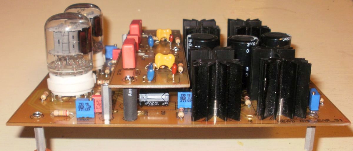

This is the second hybrid head phone amp for me. The first was a stocking stuffer

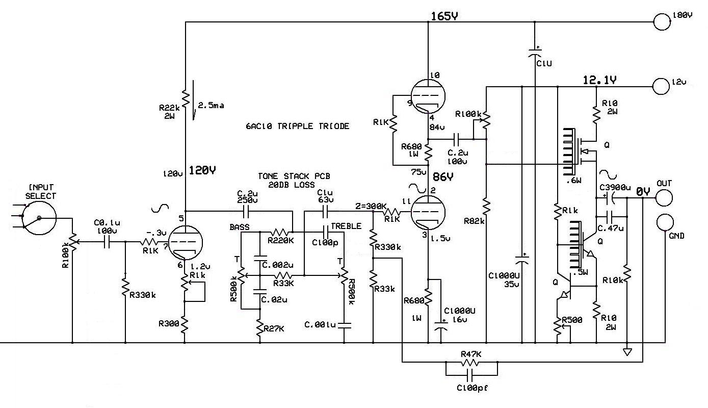

last year and the head elf liked it so much he started to make one for himself. I used Compactron tubes for 3 in one , first for gain stage and 2 for SRPP stage, with a MosFet A follower with CCS. I have used the triple triode, diode and sweep tube Compactron tubes in amplifier applications, all 12 pin tubes.
Simple topology, gain stage - tone section - buffer stage - output driver. The "GNFB" feedback is only between the SRPP and output stage, I did not want to run it back to the front end and include the tone section in the loop.
The power supplies are slow start to prevent turn-on noise and heavily filtered to make the phones "black hole quiet" with no input. I went from AC heaters to DC heaters to accomplish this.
Output voltage and quiescent current can be adjusted for application. I chose 12 V and 150ma for my phones. I cranked up the bias and drove 8 ohm efficient speakers to see if it could be done. My application is as a headphone and pre-amp for the tube power amp. I'm also including a RIAA preamp based on the groovewatt design.

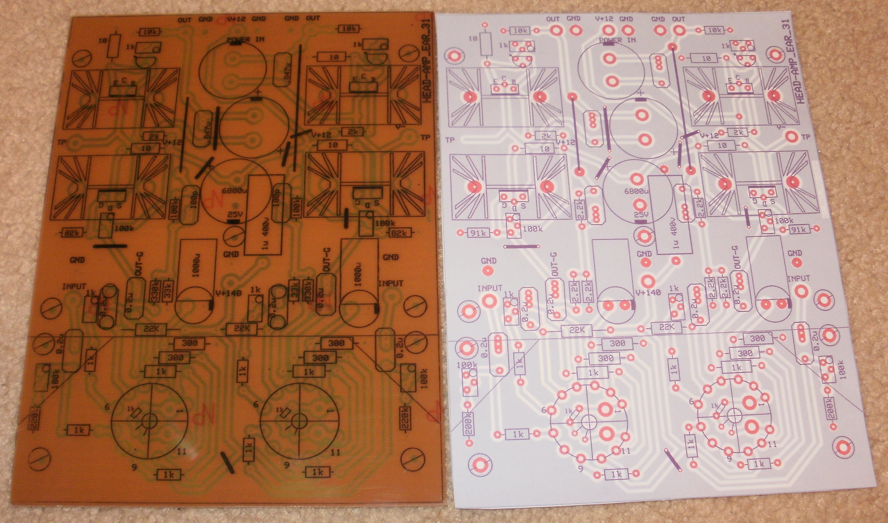

The PCB is toner transfer, etched in a Ziplock bag to contain the mess. Brass eyelets are used to mount the big caps and for wire connections.

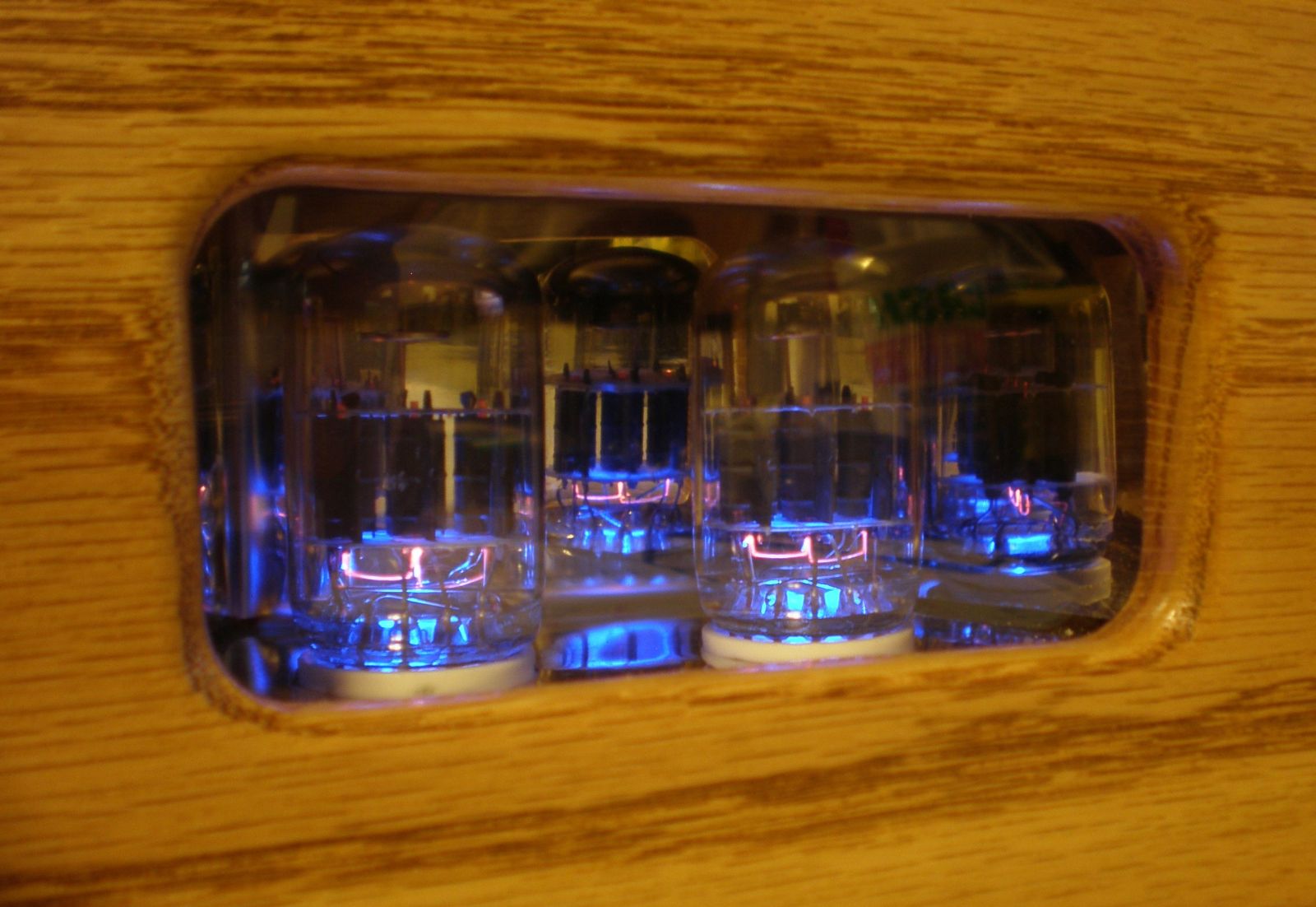

For the stocking stuffer I used mirror finish 304l stainless steel sheet as a heat shield, ground plane, reflector. The tubes are 6.3 volt in series, run on 12 volts so like old Christmas tree lights if one goes out, they both go out. The LED's under the tube are across the heaters so if one goes out, the LED goes bright to let you know which one to replace.
