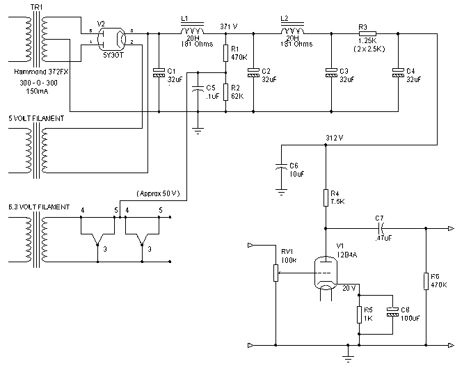

Hybrid tube front end and transistor output stage

have found several Mosfet hybrid designs but I want to stay with TO-3 outputs like the Motorola MJ15024 and MJ15025

Thanks for the link. It looks like a triple darlington output stage but its kinda blurred and I can't see it all that well.

You will probably have to run a tripple with the MJ15024/25, unless you're driving it with a cathode follower like a Foreplay.
If you want to get fancy you could reverse the driver transistors so the tripple looks like the one in an Altec 9440A, McIntosh 2120, Ampzilla III, etc. This would cut down on the bias a bit too.
If you really slam a 6C45Pi at 30mA with a choke load you could do a double with the MJE15030/31 and MJ21193/94.
What were you thinking about for the front end?

I will see if I can post this line stage.
