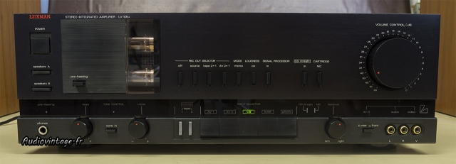

Oh @oughtsix : you may certainly remember these Hybrid Luxman amps, the LV-10x series - I think it was the first "commercial affordable attempt" from a well-known brand to integrate tubes in SS amps.
The tubes were solely inserted as cathode followers between the preamp and power sections, IIRC. Indeed, it was a 🆒 idea, yes, but I'm not sure that it was very useful...
At least, it brought probably some "Tube Magic" in the amp, and it was certainly a good marketing strategy, in the late 80s, when the tubes started to resurrect, for the better and the better... 😎
Personally, I am rather in the "adding a mere tube is a gimmick" camp... But why not, after all ? 🙂😉
