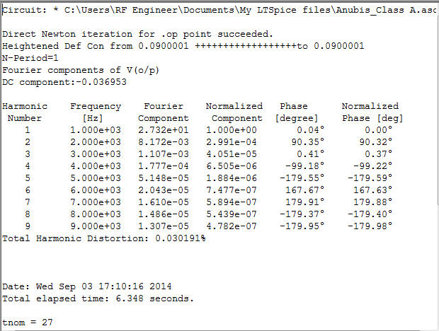

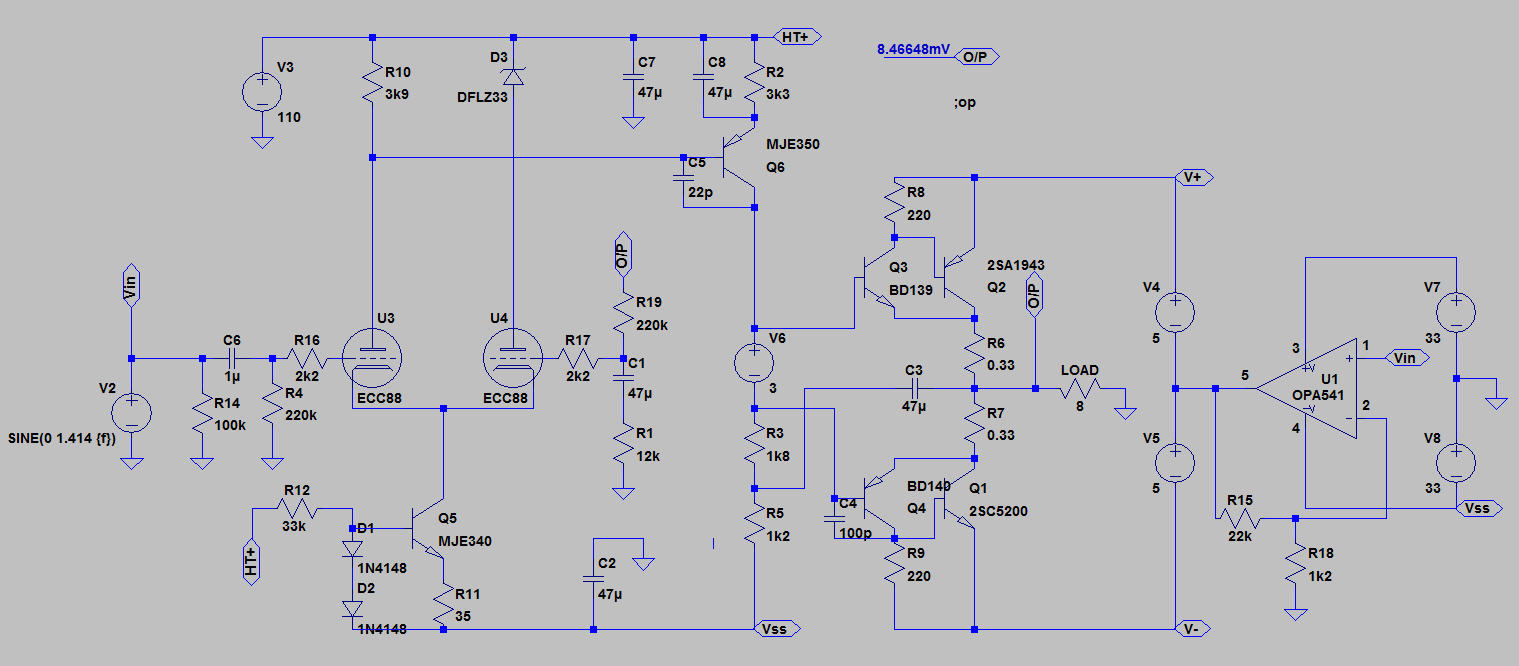

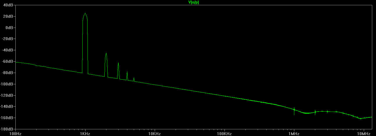

Here's my latest attempt.
As suggested by Mr.zaichenko, one of the key to a good profile is running the OPS at class A.. However, with it comes the usual problem: heat dissipation, especially if i want to keep the output power target. I tried fiddling around to see if we can get Class A even at high power output with reasonable Power dissipation (Pdiss). Attached schematic is what i have so far..
The output transistors are idling at around 10Watt Pdiss with 2.5A flowing continuously, much lower than the typical Class A Pdiss. I wanted to use the ever-popular LM3886 at first but sadly i failed to simulate it. This would be a crazy looking amplifier! BJTs, Tubes and Chipamps in one case! Sadly (or fortunately?) THD is too low at around 0.03%.. there goes the "tube sound". Only problem is the additional bipolar 5V power supply.. Perhaps Ebay buck converters can solve this problem cheaply?

Tubes doesn't mean high distortion is inevitable or necessarily desirable. I've read reports that people can make tube amps that are so clean they don't have any sound by themselves at all. The trouble with distortion is that it can sound good for awhile but once you go back to a cleaner amp you rather like the cleaner amp more. And distortion makes the sound muddy when you crank up the volume or listen to complex music. So I wouldn't feel bad about 0.03%, especially as you are using feedback.
You could simplify the design, if you want to ?
Not sure why you want D3?
Remove C8 and you'll drop the open loop gain but have more local VAS degeneration ?
What is the power dissipation of Q6, first look at it and I worry a lot, I think R3 & R5 need to be much larger ?
Forget the opamp, it brings nothing to what is already a nice amplifer ?
Perhaps connect R12 to ground instead of B+ would help with wasted heat ?

On the contrary, the opamp is the only reason why i can run Class A at high power!
The opamp is critical if i want to avoid having huge chunk of metal just to dissipate the heat of the output transistors. Without it, each transistor would dissipate about 80 Watts which translates to heatsinks the size of a mini-refrigerator.
D3 was my (futile) attempt to add more H2, it just reduces the THD even more!
Q6 dissipates about 1 Watt. I currently use small heatsink and it's running fine.
R12 was connected that way on the PCB i used. I made the original hybrid using readily available PCB. I simply changed the LTP to tubes and some other mods. R12 dissipates minor heat compared to the other component.

ah... Perhaps I don't understand what you're doing with the chip. It seems you are using it as the power supply for the output devices, a kind of rail-tracker ?
Edit: Is it functionally, any different from simply having a Class AB bias for the output stage using V6 (with no opamp) ?

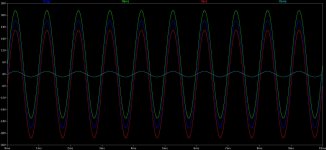

Yes, it's a rail-tracker. It keeps the output device's supply voltage constantly 5 volts above the output signal, keeping them from sticking to the rail and still running in Class A. The opamp itself doesn't contribute to the sound.

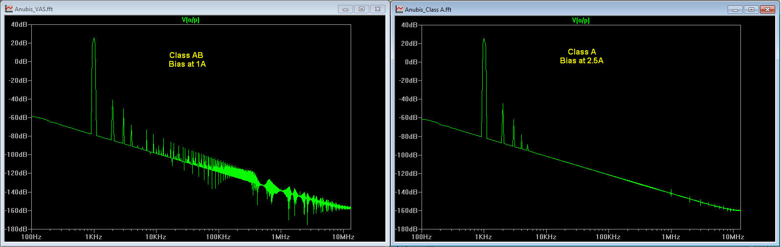

It's different from running a Class AB bias. What's the difference? It's simply the difference between Class A and Class AB. Attached is the difference in harmonic profile. Same input signal, same amount of feedback, same loop gain. Whether the difference is audible, that's another issue 🙂 Do you think it's audible?
edit: THD at Class AB is 0.048%
Very cool idea. But I'm not sure why you're saying that the opamp doesn't contribute to the sound ...
The way i see it, it's the same thing as supplying the output device with constant +/-33V and biasing at 2.5A, only with much less heatsink requirement. The op-amp merely ensures the supply voltages "envelope" the output signal. You can see this enveloping simulation on post #24, last image. Did i miss something?But I'm not sure why you're saying that the opamp doesn't contribute to the sound ...
i guess its just a matter of perspective - as it looks to me that the results will also depend on how well the opamp produces an 23x amplified copy of the input signal. Still like the approach though 🙂
