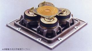

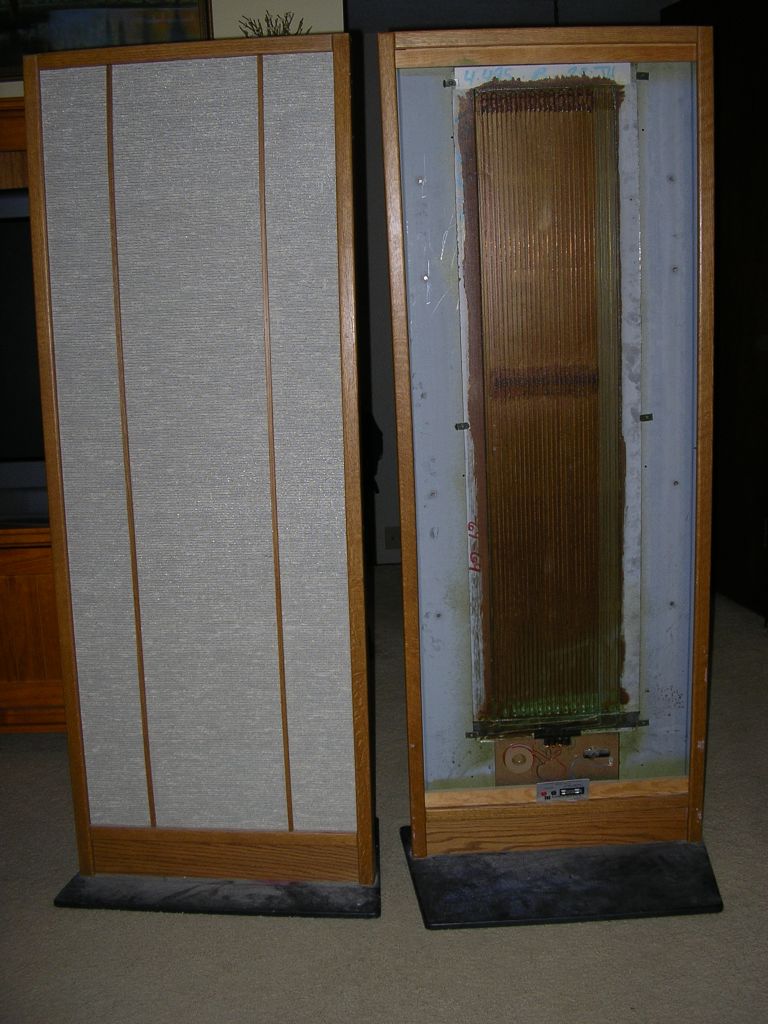

a speaker that uses many permanent magnets each with its own voice coil (same principle as the cone loudspeakers), all together moving a single large membrane (as in planars).
practically a hybrid that combines the characteristics of two different worlds, magnetoplanar and cone magnetodynamic loudspeakers.
exist ? to you it appears that some builder or some do-it-yourself has tried to build one? .
how do you think it would be?

not to forget the Technics AFP series, models 10, 100 and 1000.
Seemingly such drivers became too expensive to build as the ´motors´ required close matching to not generate additional bending modes on the membrane.
