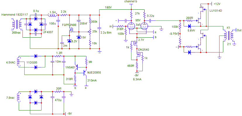

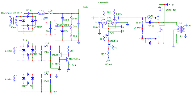

I just put this thing together. Test results to follow. The output end is based on the Zeus design by Susan Parker. My transformer driven version is described in the last few pages of her long thread. http://www.diyaudio.com/forums/showthread.php?s=&threadid=42259&perpage=25&highlight=&pagenumber=1
I wanted to make a tube driven version, so I can drive it with anything, as the transformer version requires a low impedance driver, and well, just because. Nothing like taking a perfectly good design and driving it into the ground.
Here's the amp and power supplies for the driver. Each channel has a separate filament supply. The extra windings for the filaments and tail supply are wound on the driver power transformer.
The power supply for the output section is in the following post.

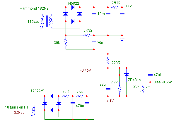

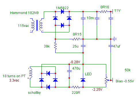

OP Power and bias supply
One supply per channel. The weird design is to create a feedback loop to stablize the bias as the output devices warm up. As the bias current increases, the reference for the bias shifts more negative. The dropping resistor on the return of the main supply is sized so that the bias doesn't drift.

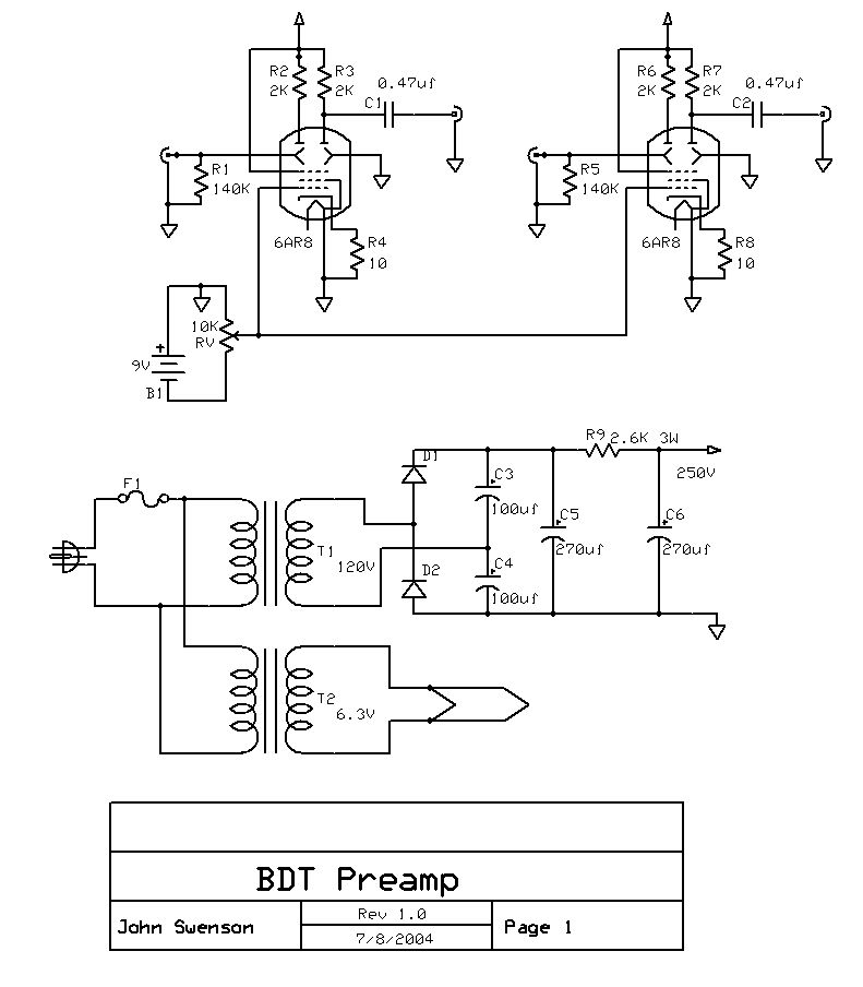

As you are doing a bit of shenanigan & you seem to enjoy off-beat design - did you ever consider the 6AR8 tubes for phase splitter duties & vol control in this design? A modified BDT preamp ala John Swenson

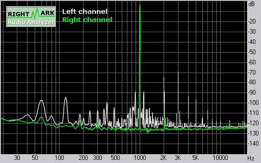

Here's some distortion measurements at about 1 watt output. Looks like I could still do a little work on the output section power supply.
I haven't worked with those tubes, though I seen that design and it looks like it would be cool to try.
