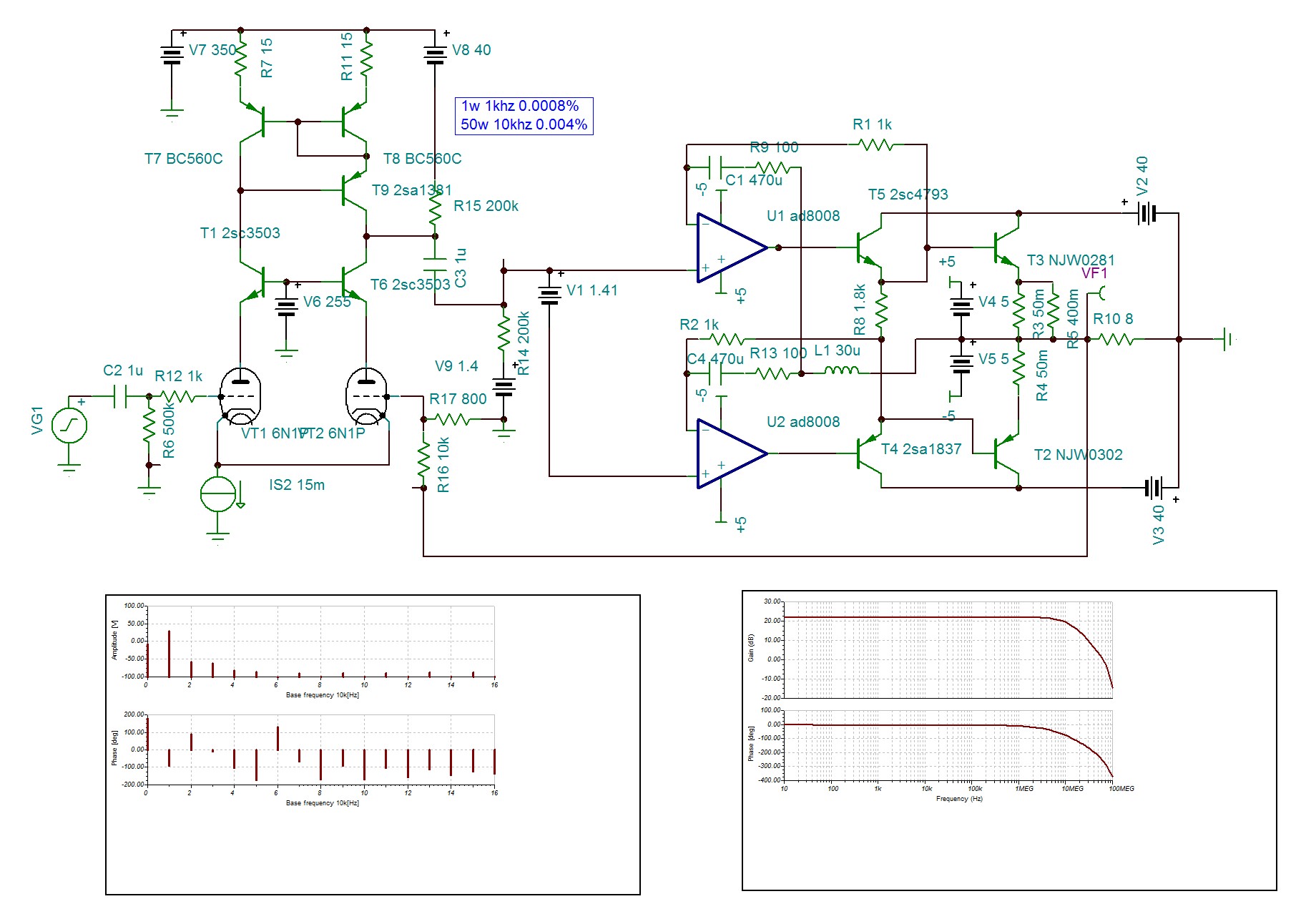

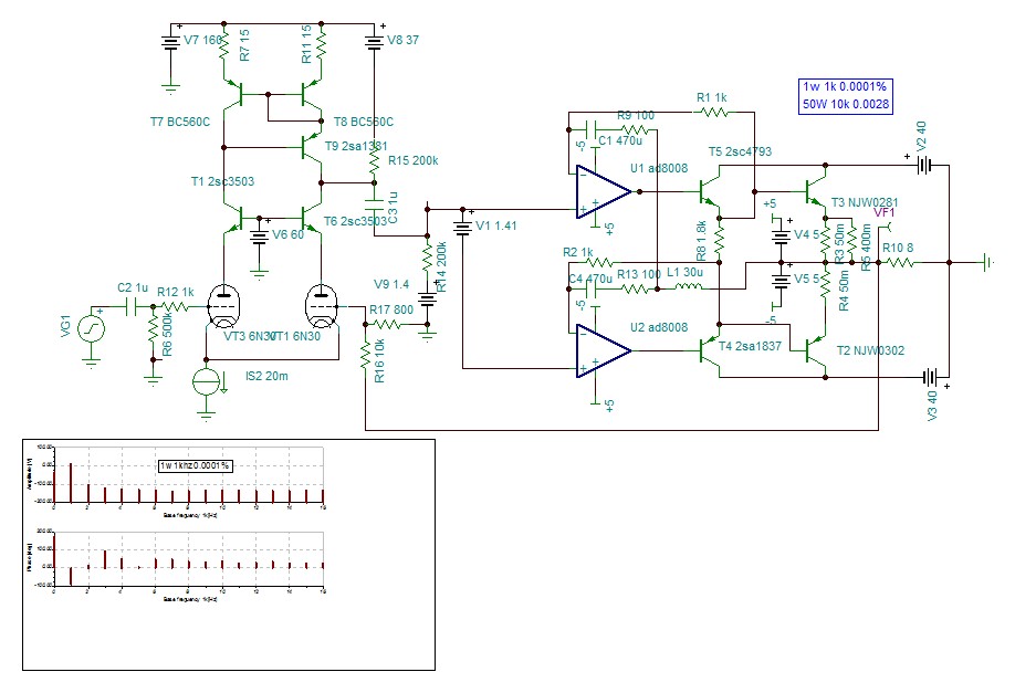

U U130421 Disabled Account Joined 2015 2020-07-05 6:04 am #1 2020-07-05 6:04 am #1 Attachments HYBRID NON SWITCHING.JPG 302.3 KB · Views: 628 Last edited: 2020-07-05 6:09 am U U130421 Disabled Account Joined 2015 2020-07-05 7:25 am #2 2020-07-05 7:25 am #2 Enhancements . Perfect square wave 10khz. Attachments HYBRID NON SWITCHING.JPG 306.1 KB · Views: 568 Last edited: 2020-07-05 7:30 am U U130421 Disabled Account Joined 2015 2020-07-05 10:08 am #3 2020-07-05 10:08 am #3 Using the expensive 6N30 for very low distortion. Attachments HYBRID NON SWITCHING.JPG 89.8 KB · Views: 356 You must log in or register to reply here. Share: Facebook X (Twitter) LinkedIn Reddit Pinterest Tumblr WhatsApp Email Link
