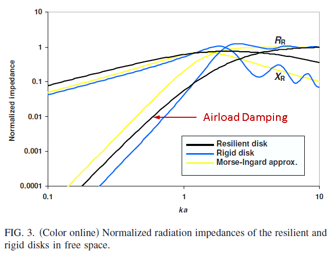

I had investigated the damping potential of closely spaced wires and/or low %OA(Open Area) perforated sheet stators…thought I had posted it years ago, but can’t seem to locate. In any case, you will need to get %OA < 20% before significant amounts of damping is seen, and then only if the holes or slots are quite small, something less than 0.02”. As an example, attached is measurement of a KLH Nine woofer that has roughly 10%OA. Still not much damping as the holes are about 0.1” diameter.
What does help with acoustic damping in hybrids is to increase the resonance frequency so it gets closer to the ka=1 point below which acoustic damping drops off like a rock…see attached pic of radiation impedance with the resistive damping curve pointed out. The ka=1 point is defined by the width of the ESL panel, roughly equal to the point where wavelength is the same size as width.

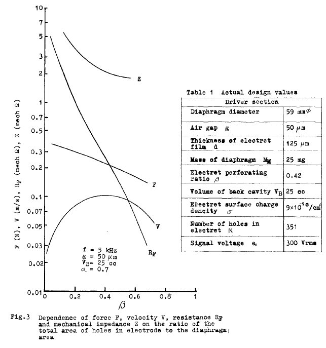

I had imagined that closer wire spacing might provide some damping as an added benefit, but the primary reason I targeted 42% open area was for efficiency.
Back in the 70’s, Panasonic Corp did some research on electrostatic tweeters which showed that the optimal (i.e. max acoustic output) open area was 42%. I don’t recall whether the data was limited to tweeter frequencies or was applicable to the full audio bandwidth, only that it was a graph showing open area percentage on one axis and SPL on the other axis.
I just did a Google search for that chart, but I didn’t find it-- I will keep looking and post it here if I find it.

Was it perhaps the attached figure/table from this AES Convention/Journal article?
(Panasonic was one of the brand names Matsushita used in the 70s )
"Frequency Response Considerations for an Electrostatic Horn Tweeter Using Electret Elements,"
Publication: J. Audio Eng. Soc., vol. 24, no. 5, pp. 368-373, (1976 June.).
Authors: N. Sakamoto, T. Gotoh, N. Atoji, and T. Aoi,
Affiliation: ACOUSTIC RESEARCH LABORATORY, MATSUSHITA ELBCTRIC INDUSTRIAL CO. , LTD.
AES E-Library >> Frequency Response Considerations for an Electrostatic Horn Tweeter Using Electret Elements
AES E-Library >> Frequency Response of an Electrostatic Horn-Tweeter with Electret
