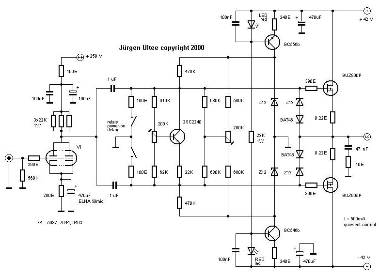

HI!
What do you think?
Elyt caps wrong connected .....

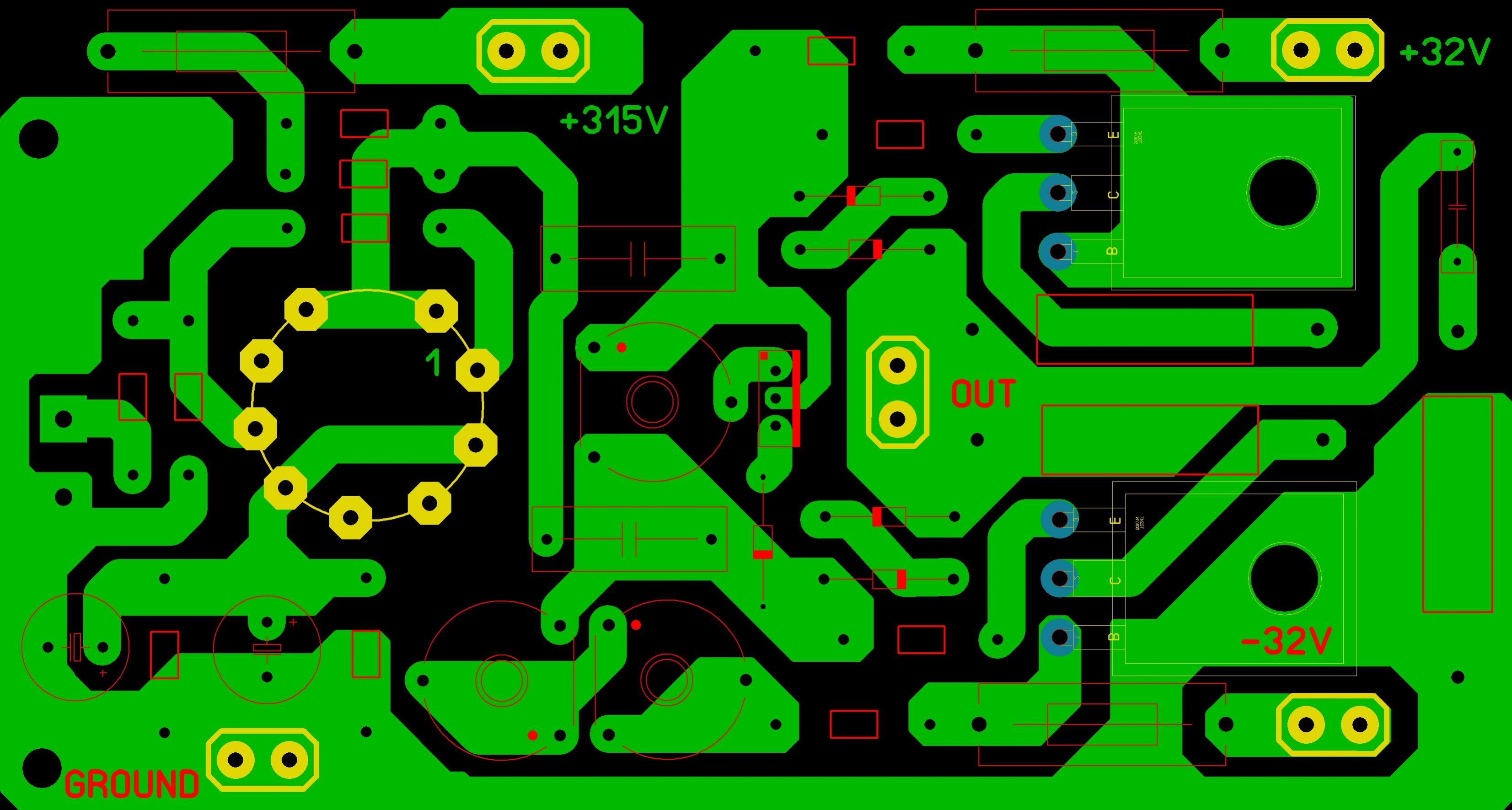

... elyt capacitors must be connected between the plus rail and ground , and minus rail and ground , not between plus and minus , see PCB ! Resistive trim must placed on PCB not capacitiv ...... 😕
Regards Alex.

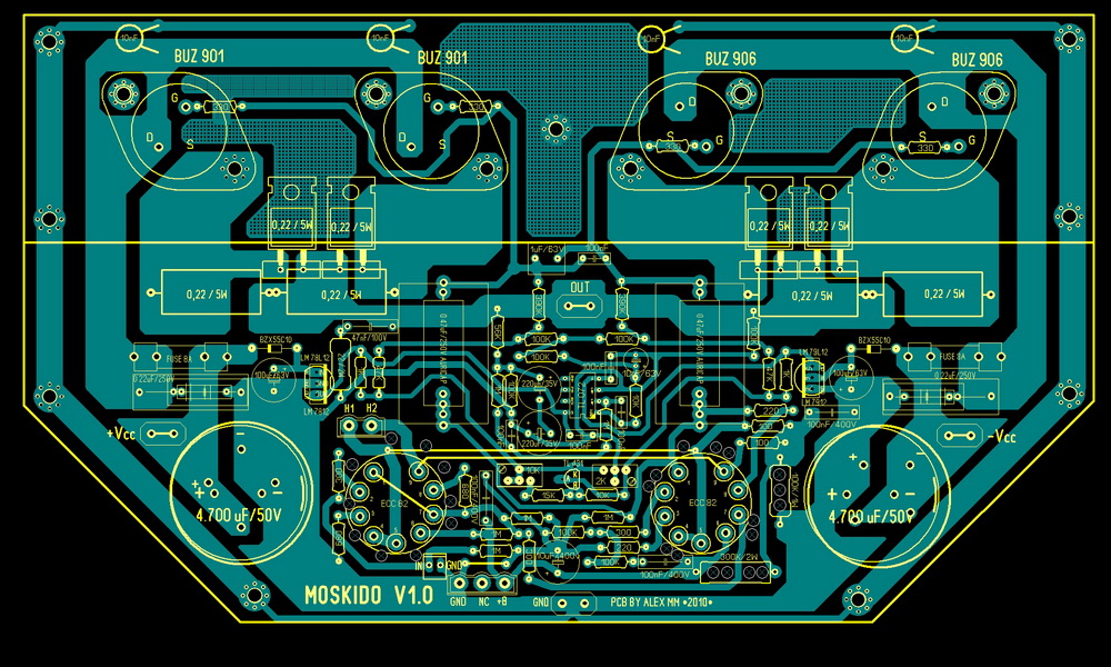

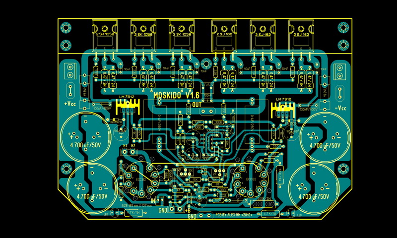

Hi Alex,
Just found your posting of the pcb's
Any chance that you would care to share the pcb files?
It would make life so much easier for newbies and people who are interested in building a moskido but dont have the ability to design a pcb like me.
I have been interested in a moskido for some time but found hard wiring it too daunting.
