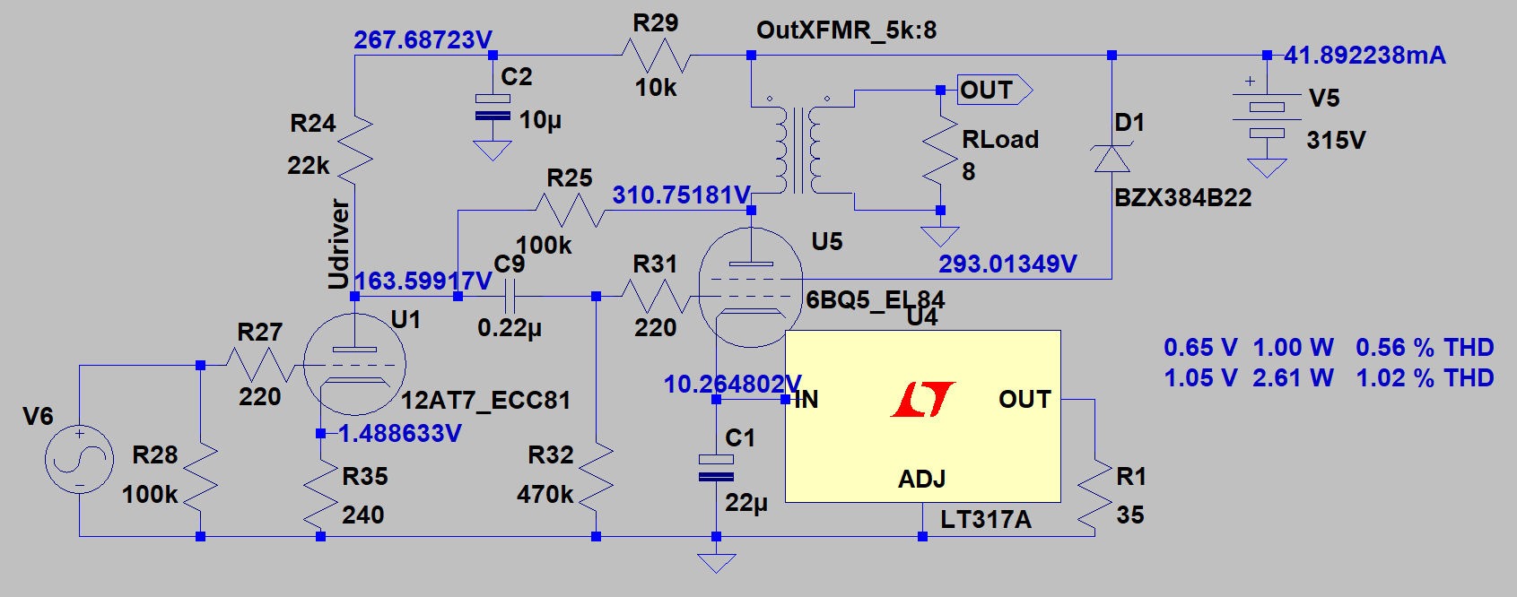

Such large cathode capacitor is overkill.Here is a simulation ...
Even if you use CCS in the cathode, the AC blocking capacitor value not orders of magnitude larger, than in cathode bias case.
Sample:
Larger C1 gives lower -3dB point, but can cause anomalies (in this case due to the Schade feedback).
It's value must "fine-tuning", depending of CCS parameters (such stabilizer, simple or cascode BJT, FET etc.).

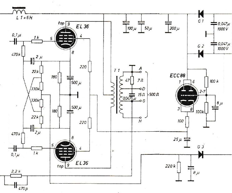

Here's an interesting variation on the theme, with cross-coupled biasing, from 1966. Courtesy of Menno van der Veen (it is mentioned in his book).
That is an interesting circuit. I don't recall seeing it before. Imagine one valve draws slightly too much current. Its cathode voltage rises slightly and that lifts the voltage on which the potential divider to the other valve's grid sits to go more positive, turning the other valve on more to balance the system. Those potential dividers (22k, 330k) must need careful choice of values to prevent the system driving itself into runaway. But if the circuit is from 1966, resistor tolerance will be pretty poor. Anything as tight as +/-5% was usually marked. I wonder if the extra complication was really justified.
And the (pure pentode) circuit has regulated g2 supplies. That must be straining the heater-cathode insulation of that ECC88. And if the HT was 400V, that 100k, 100k potential divider puts Vak for the ECC88 at 200V. ECC88 is only rated for 130V. Not a good design choice.
Yeah, but it's positive feedback for bias voltages, so you have to wonder if he'd actually tried to do this. And also, why?

It cannot runnaway. Reducing the 22k resistors simply forces the two valve to settle closer to the average of the two currents they would have conducted without the cross coupling.Those potential dividers (22k, 330k) must need careful choice of values to prevent the system driving itself into runaway.
Apparently it was 150V at the cathode of the ECC88.
