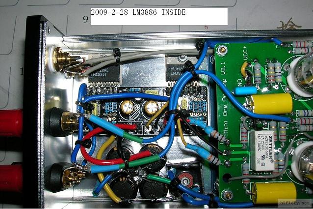

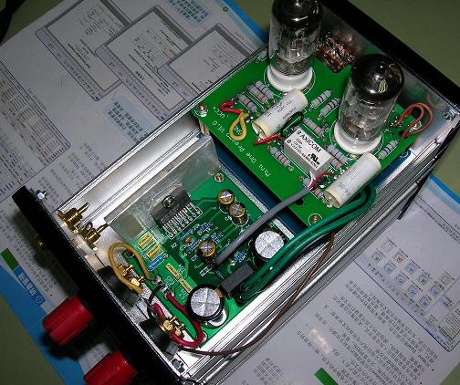

Another picture for my amplifier.

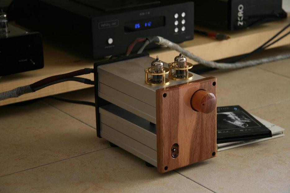

Looks great.
How does the unit sound ? Especially the comparison between the chip amp on it's own and the one with the tube input stage ?
I ask this because I built a chip amp that sounds wonderful. Then I added a tube input stage to increase input impedance and get a little extra gain . It killed the original sound. It was still very nice especially the mid range ( which seemed to be more 'real' ) but it sounded 'less dynamic'. Compressed is a crude word but describes it closely. I used a 6DJ8 runnig on 120 volt supplies.

Sorry about the delay. I don't have the circuit on this computer but it's quite simple. Its a 6DJ8 with a ccs anode load and a cathode resistor with no bypass capacitor. The ccs is a simple two transistor circuit with a BC556B and a MJE350. Output is coupled with a film cap. Power supply has a capacitance multiplier ( no voltage regulation ).
I run the tube at about 5mA IIRC.
Smooth sound but loss of dynamics compared to the chip on it's own. Mid-range seemed to be nicer with the tube !
Cheers.
Nice setup. But I guess a bit fiddly to assemble ?
