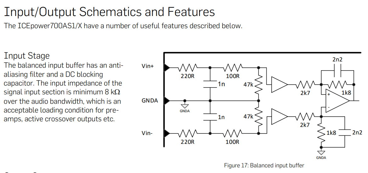

Did you read the very good and complete manual of the ICE 700? It covers really anything I can think of. Please read!
This amp has a symmetric input buffer with 2x 47k ohm. The circuit is on page 24/46.
There is no problem (it is described in the manual!) to use a single ended pre amp. Just ground the cold (-) input and use the hot (+) input and you are done.
Any additional "buffer" is useless and would only degrade sound quality.
If for some reason you want to induce valve made distortion into this perfect amp, use a 1uF capacitor and put a gain 1 valve stage in front of it.
Sorry, this whole tread is based on wrong information.
If you get an older ICE module, like the 500, 1000 or 250, the input has no buffer and 8k ohms input impedance. These modules need a symmetric buffer to reach full potential. As far as I know the rest of the amps (700-500 etc) is mainly identical and "sound" is just as good.
All ICE amps are very good and if implemented right you will not be able to find something audible better. Off course, only if you are objective and ignore marketing hype.
...If you get an older ICE module, like the 500, 1000 or 250, the input has no buffer and 8k ohms input impedance.... These modules need a symmetric buffer to reach full potential. As far as I know the rest of the amps (700-500 etc) is mainly identical and "sound" is just as good.
The 8k minimum input impedance is mentioned on p24 in the manual provided in the 1st post of this thread. Since he is intending to use a SRPP tube preamp as frontend, this is probably a bit low w/o a buffer...

I clearly stated, the 700 does not need a buffer or pre stage, it can only sound worse if you put something useless in front of it.
It already HAS A BUFFER STAGE!
Read the f***** manual!
The input has 47k Ohm impedance! Not 8k!

I did read the manual, but the issue is I don’t understand everything in the manual, and not everything can simply be googled for every scenario either. That is what these forums are for. I did not know that the 47k resistors explicitly set the input impedance.

Here is the input buffer of the 700asi-x.
The older 500ASP /250 /1000 did not have this buffer. You had to add a very stable, summetric (!) buffer to the circuit, otherwise a low impedance, changing over the frequency band was the result.
If you put one end at ground and feed it by a single ended pre-amp, the sound quality was compromised.
Exactly this missing buffer is the "Evolution" of the newer modules. Simpler to integrate.

Ignore the 8k in the text. Look at the Schematic.
