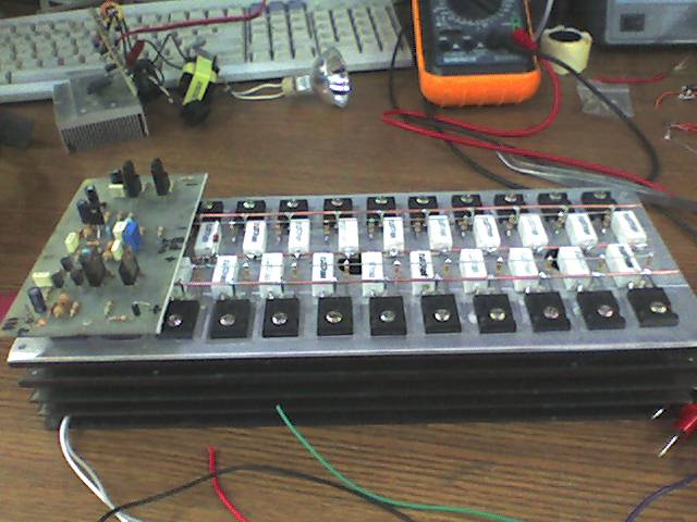

from the picture i ve seen .......
this will not stand full power ...... if you push it to the limit is simply gona blow......

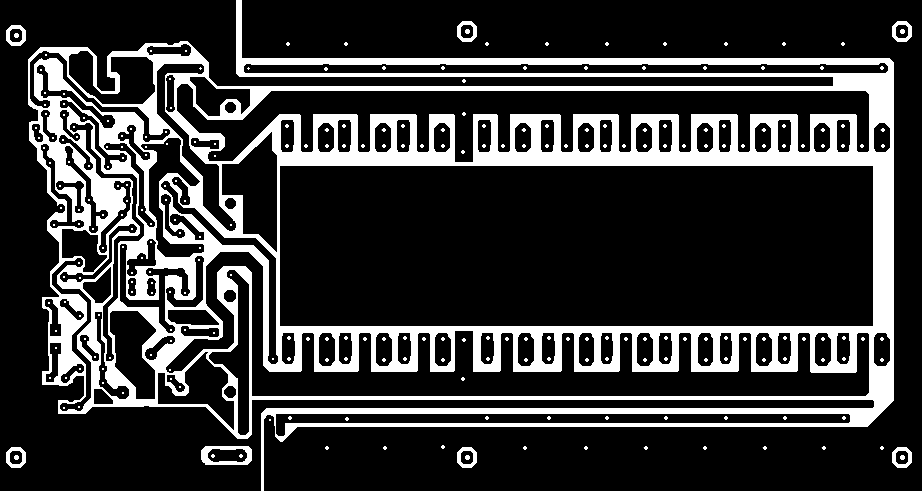

laying all these transistors on a heat sink and using just a piece of wire to supply them will have a serious drop of voltage from side to side ...... i f you supply them in the midle then you will have drop in the voltage on the sides ...... if you supply them with more than one cable will solve the voltage drop problem but to my opinion will also create ocilation ......
different voltage in every trs will create the thing that actually some transistors will not help others or not share load ecually..... curent resistor also will not help in this level of diference
let us now how it works i am curious
this amplifir functionality with 2 years never nou problem in functionaliti in 2 yars la power suply +- 115 vcc this amplifier ist very good in functionality end very strong mr hohton is one genius scuzmi for bad englich anthoni(the saint) ist the best:nod:
