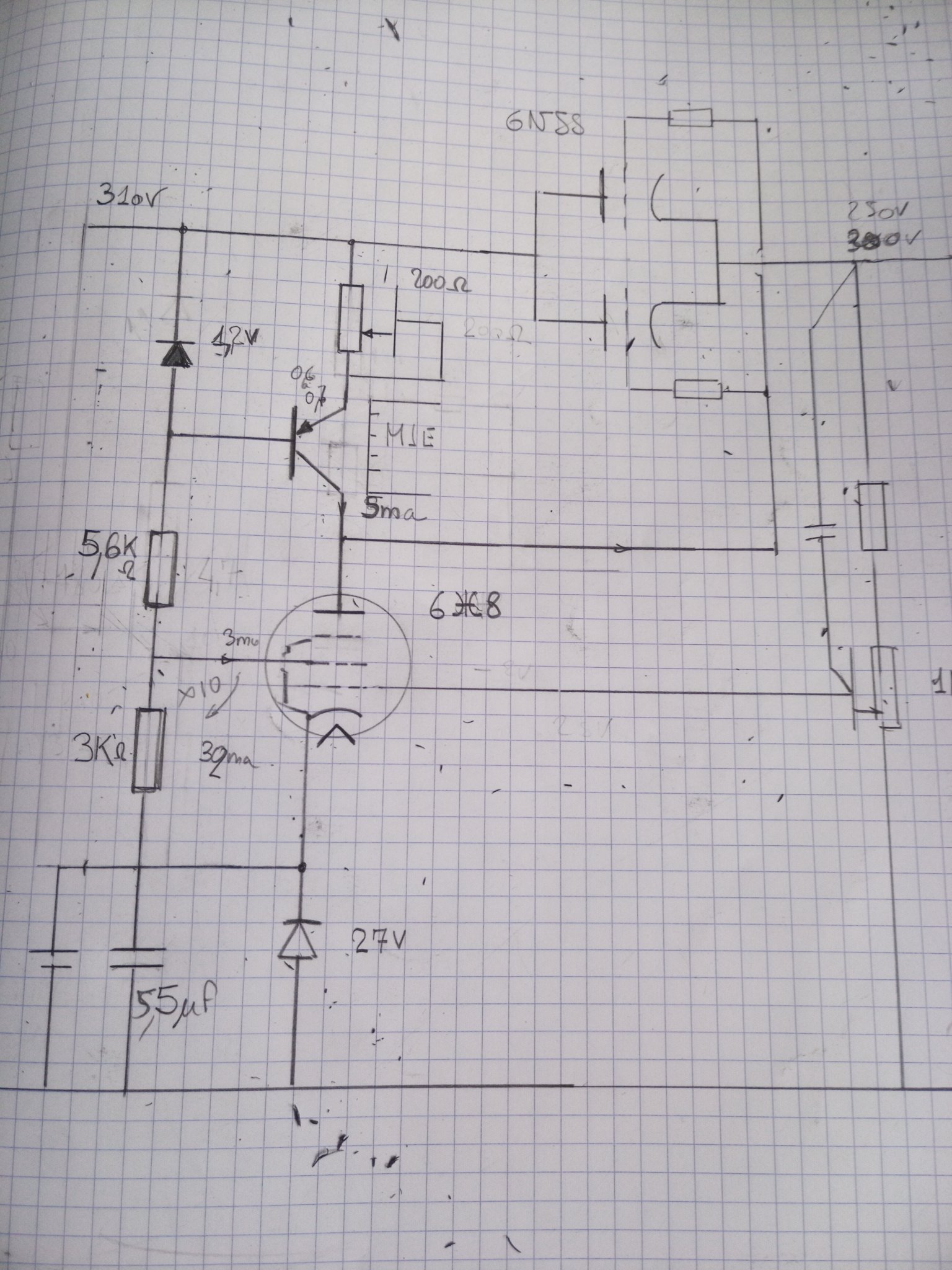

Current source and pentode or triode strapped was a choice between response and milliampères.
I speaked to you too fast, sorry.You dont really have to, that capacitor is there to direct AC from the main output bus, its a high pass filter, that is not too critical to the functioning of the circuit. 47n-470nF will work OK.
Furthermore you can get a lot better gain by putting the error tube 6SJ7 in pentode instead of triode strapping it. for that the output divider with two 10K 3W resistors will suffice.

I will try pentode wiring.

Hello,i have just tested the pentode mode with two 10k resistors:
Response is faster than triode strapped mode.
But it seems to me that the output voltage headroom is thinner:
Pentode mode: 182v to 293v
Triode mode:less than 150v to 293v (from memory,i didn't care of the 150v value)
Should i change the 43k anode resistor for a lower value ?

I hade made a trial with a 22k 10w anode resistor :
Output voltage seems higher:186vto 295v
All trials were made with a 4,7k load.
[/url][/IMG]
A trial with a sg2s (75v) voltage regulator tube gave me a little bad smoke near the ampermeter... and the tube brighted very strong but it can handle 30ma.
The output voltage has reach a lower value (near 150v) but can't reach 295v
Yes I have and your circuit will work fine, except that you may need to re-evaluate the screen grid divider, or better still, run the entire current source from the output.
Je vous remercie pour votre réponse.
La tension d'écran doit donc être très precise.je vais creuser.
