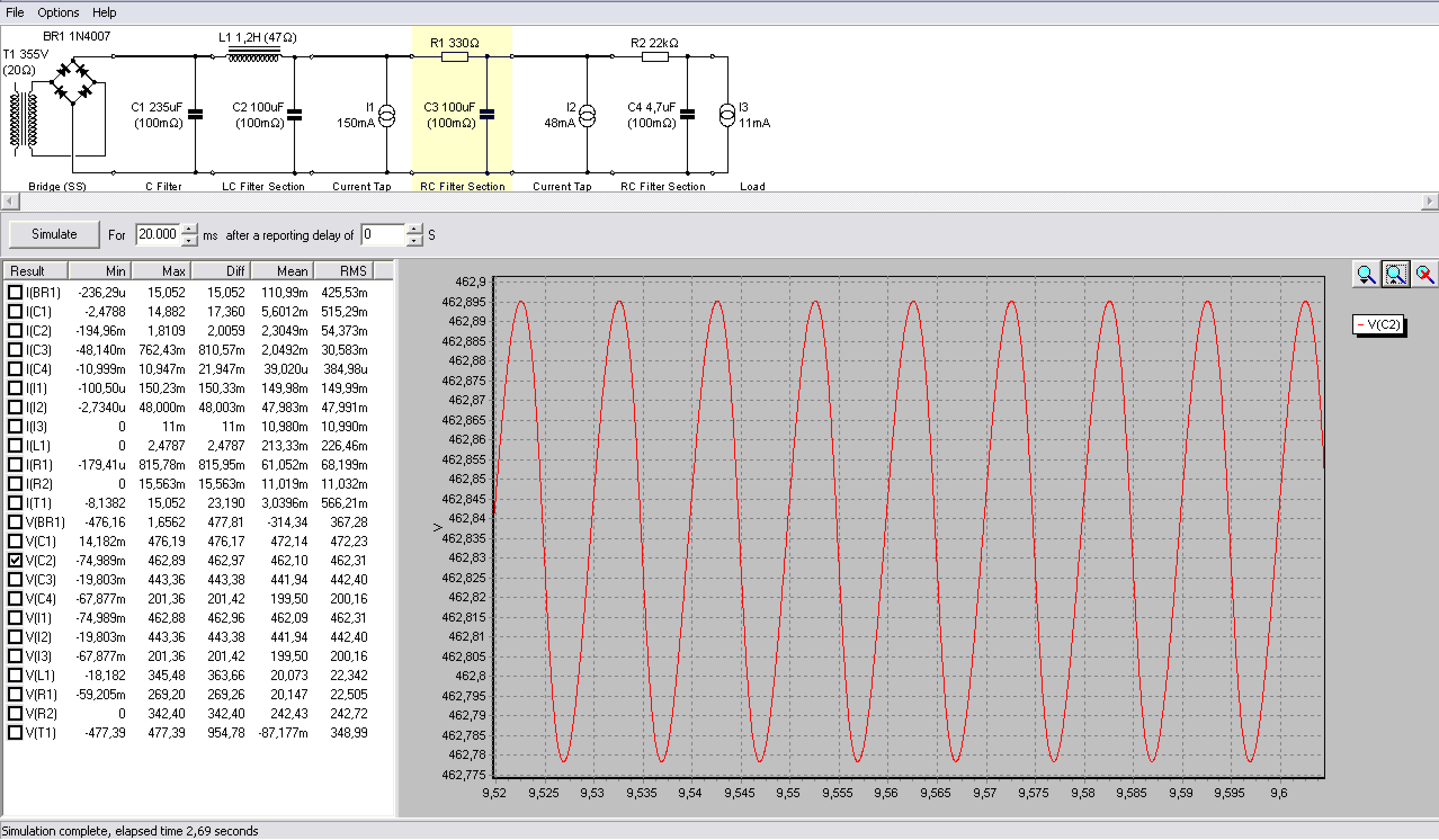

You seem to be using current sources in your PSUD model. That's not a very realistic representation of how tubes conduct at start up. At the very least I would replace the current sources with resistors instead, so the load current is proportional to the supply voltage, rather than always at maximum.
Which one are you talking about? I tried it with cap values of 0.01uF to 20uF for the first cap and the results were the same.
C1 and C2 (and probably C3). Referring to the PSUD schematic.
20uF should be enough for all three. C3 can still be on the large side, but expect to see similar current draw if you do (because, if the input side comes up instantaneously, there's about 500VDC across 330 ohms, or 1.5A peak again). So you might increase the resistor, which will drop DC, so you may have to change a few things elsewhere in the circuit.
A larger choke would be very helpful, too. Your load resistance equivalent is about 2.5kohms. Your filter values are around 100 ohms. Mismatched filters are undesirable. Not that you'd expect to be able to achieve a 2500 ohm, << 120Hz filter (for C = 20uF, you'd need L = 125H), but a higher impedance (meaning, smaller C and larger L, while keeping the L*C product constant so your ripple attenuation stays constant) is definitely desirable.
I should think a 5 or 10H choke would be easily enough available, without spending much DCR, or wasting space or $ (hah, size, weight and cost are usually seen as positive attributes anyway, so go nuts).
BTW, the power transformer's DCR should include the primary side resistance. If it's a dedicated (one secondary) transformer, then the secondary referred equivalent will be about double the secondary DCR (which is to say: the primary and secondary winding losses will be balanced). Or you can measure it directly (i.e., primary side referred), and convert it to secondary-referred by using the square of the turns (aka voltage) ratio. If it's not a single-output transformer, then, simply ignoring the other windings and proceeding as above, will give you a slightly optimistic output voltage, but it'll still be close enough.

I can't seem to be able to do that. I can only replace the last current source with a resistor, but the intermediate ones can't be replaced with resistors. Or I can't seem to figure out how.

I only used PSUD a couple of times, years ago, but IIRC I think you have to demolish the whole filter chain and rebuild it with resistor-loaded stages instead. Or just use a proper circuit simulator.I can't seem to be able to do that. I can only replace the last current source with a resistor,
I have the whole circuit in LTSpice, and I have an even larger current spike there.
So that should be as real as I can simulate it (I think).
But I will play with the cap/choke values and see if I get a better result.

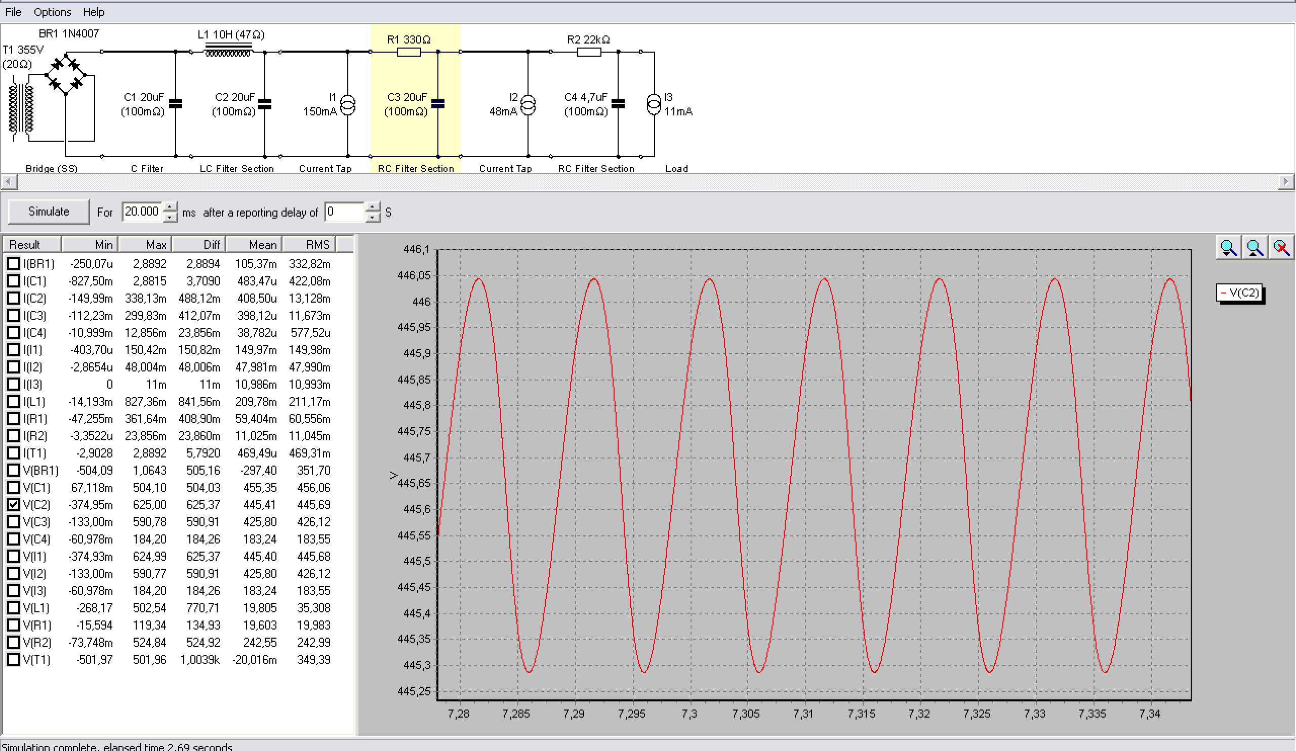

I tried a sim where I used 20uF for all three caps and also used a 10H choke.
The result is a ripple of 750mV vs a 110mV as I had in the first version (after the choke). With a 5H choke the ripple was double.
This way the current spike is around 1A.
What I want to understand is this:
Does the smaller 1A current ripple justify the use of a larger and more expensive choke, and this way having a x7 ripple versus trying to address the current spike in my first version with an auxiliary circuit? Something with a relay that shorts some resistor or thermistor after a few seconds?
Also I added 3 ohms for the primary DCR. I figured it couldn't be more than that. There will be a HV transformer and another smaller one for the heaters/bias etc
I think the advice you've gotten to increase the choke value is right on. You may as well not have a choke with the previous choke you had. And again, that 20uf first cap is good advice whether you believe it or not. That combination will go far to tame that choke surge. I'm not so sure it's a good idea to have such small 20uf caps after the choke. That's what's causing the higher ripple in your sim, not the choke replacement. The 20uf first cap and the much higher 5 to 10 henry choke value is just good practice for the current you're running.
With 20uF/10H on the input I get about 150mV ripple. Still a tad higher than with 235uF/1.2H.
What I'm trying to understand is this. How is it better? I thought the main criteria for a rectifying filter is to smooth out AC, to have as little ripple as possible.
Given the two scenarios, the higher capacitance/lower inductance wins from a price and performance point of view.
Is there anything else that should be considered that would justify the x10 value choke? (and possibly way higher price of it). As it stands, I already ordered the transformer, and that means that I can't afford any increase in the DCR of the choke, and to be able to get it at 50-60 ohms I would need to use thicker wire, and that would make the choke pretty huge, and again, expensive.

I made some sims and indeed the conduction angle is a bit longer with 23.5uF cap on the input, and the current peaks are a tad lower. And on the first cycles indeed the current spikes are way smaller.
I must deal with two more things if I do this.
First, the overall voltage is lower, especially under full load. I lose about 20V I think.
Second, I noticed this and maybe need some clarification.
The current peaks on the first cap are about 1.14a to 1.45A depending on the load.
The 470uF caps (in series) that I planned on using on the first iteration have a rated ripple current of 2.51A at 85°C/120Hz.
Most of the ones I can find at 47uF (400-500V) have a rated ripple current of about 420mA at 120Hz. I will need it for 100Hz but almost the same. The best one seems to be this: 47uF/400V - http://www.farnell.com/datasheets/24536.pdf with a rated ripple of 1.2A at 100Hz/40°C or 0.79A at 100Hz/85°C.
Even so, I'd need to buy 4 and put them two by two in parallel/series to share the current.
Is that correct?

After reading Valve Amplifiers I decided to make some more sims.
I also used resistors instead of current sinks.
Using a 23.5uF (practical value) for the first cap I got peaks of 1.06A on the first cap (after the ps settled).
Using a 235uF (practical value) for the first cap I got peaks of 1.11A on the first cap (after the ps settled).
The effective reduction is of 50mA. As an absolute, this could be considered an advantage.
Then I looked at the current spike on the choke and indeed there's a difference. With a 235uF cap (1H/100uF) on the first position there's a max of 1.35A on the choke.
With a 23.5uF cap (10H/335uF second cap) on the first position there's a max of 1.74A on the choke.
So this is a disadvantage. Again, how much that counts in real life I don't know.
I then looked at the current surges on the first cap at startup and the winner is the setup with the 23.5uF cap in the first position.
These are the results:
23.5uF/10H/335uF:
235uF/1H/100uF:
Of course these surges will be dealt with with the use of a thermistor that will be short circuited after some time.
So that leaves me with the question:
Is it worth, from a practical side of things, to try and find high current ripple rated 47uF high voltage caps to connect them in series/parallel and then spend the extra cash on the large 5-10H (400mA/ 50-100ohms DCR) choke?
After looking at Mr. Jones's examples I stumbled upon his HV power supply used in the "Daughter of the Beast" amplifier. This is the schematic he used:
As you can see, he used a 470uF/1H/470uF arrangement. Sure, the current needs are larger, 1A vs 0.35A. He also notes that the increase in size of the choke from 1H to 10H doesn't justify it.
And here's the current on the first cap in this particular PS:
Also the current into the choke:
The way he dealt with the current spike problems was simple, a thermistor on the primary. Exactly my intentions.
