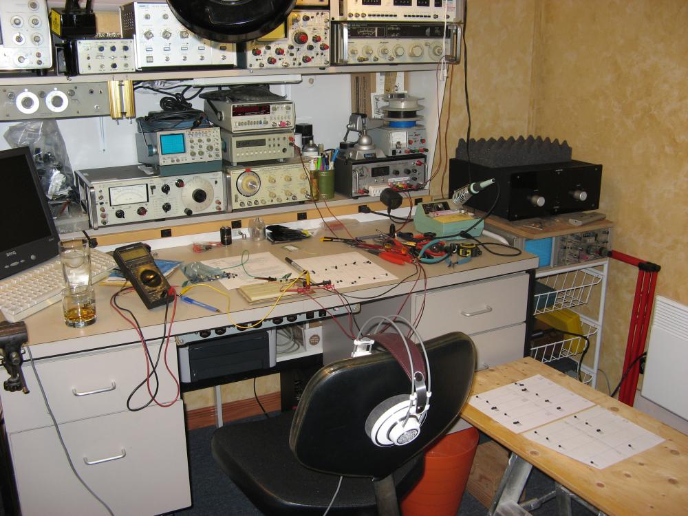

Got an evening to kill. Decided to test all the FET. Here the test setup. I can test 2 FET at the time. All FET are testing good.
