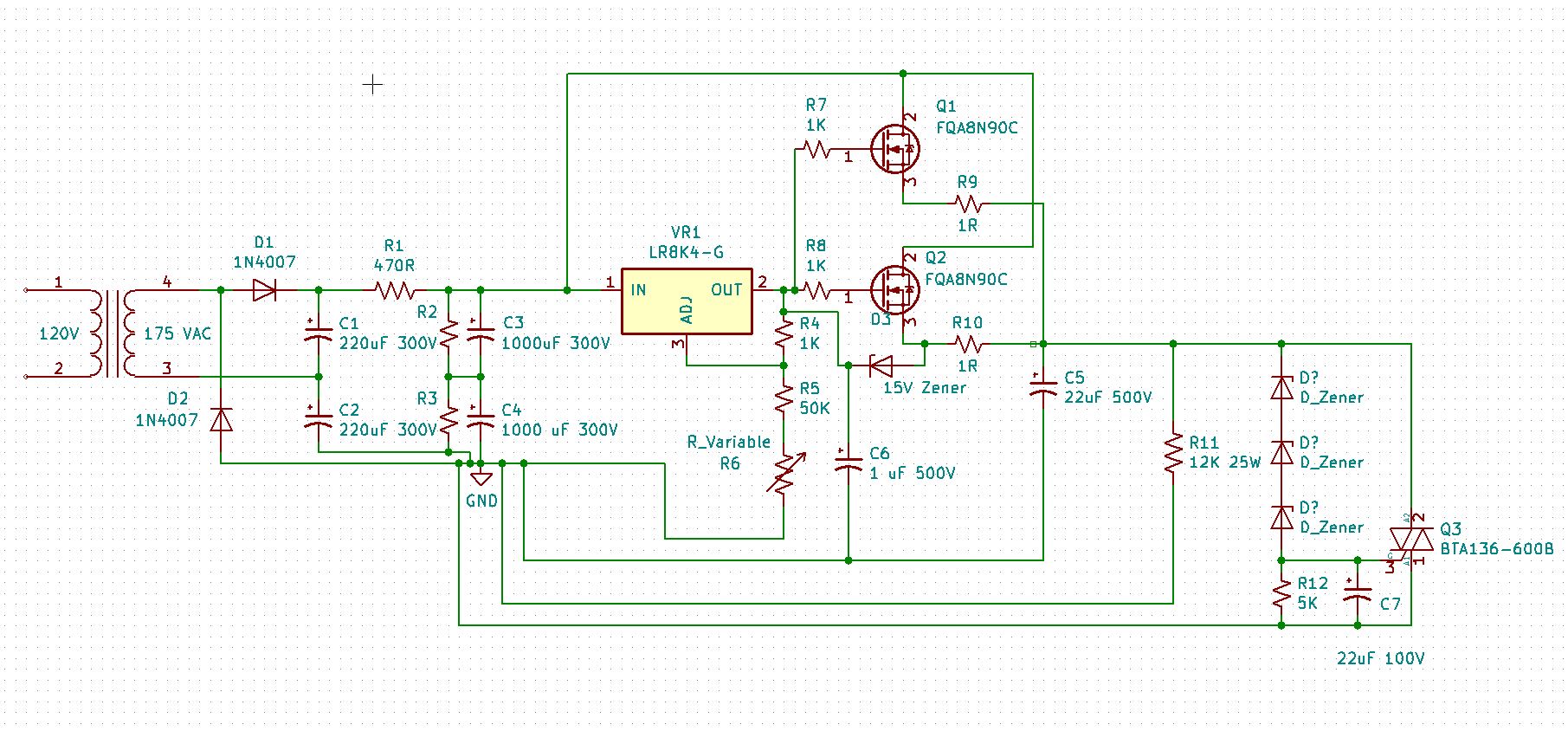

Thanks, attached is the general idea I had in mind. The guys over at the EEVBlog forum suggested a crowbar circuit (as can be seen) and I was also thinking about implementing a high/low range selection switch employing multiple transformer taps that would mean the pass devices never have to drop more than 300V across them.
Much digging through the Digikey catalog turned up this part as a reasonably priced option for the pass elements. I think that a pair of these FQA8N90C-F109 1000V MOSFETs would probably be sufficient.
Also, you can bet I'm going to put some significant effort into ensuring the pass elements are cooled properly. That means big heatsinks. The heatsink will be isolated from the chassis. This is important, since I will NOT be using Mica spacers in an effort to improve thermal transfer. I'm planning to mill the surface of the heatsink flat, and I'm going to devise a clamping system to get the clamping pressure as even as possible. I'm also probably going to employ a fan-cooling system that will run depending on the heatsink temperature. This should improve thermal stability.
As of right now, I still need to come up with a current limit function, as I haven't been able to find any BJTs that would be able to take the stress.
If anyone has an idea for a solid state current limiter that wouldn't blow up before the devices it's trying to protect, I'm all ears. I'm planning to just leave it fixed at 750 mA, the idea being that if the DUT shorts, it doesn't blow the FETs.

Consider however that even with a hi/low switch the supply still needs to withstand a shorted load when on the hi setting. A shorted load can drop no voltage (it's a straight wire), so the supply must drop all the voltage--at max current limit currently set. That could be a very stressful situation on the silicon and in worst case could mean dropping the entire B+ amount, which could be way more than 300V, unless the crowbar circuit is going to disconnect the load under those conditions.
This is part of why I'm planning to implement a current limiter.
The idea behind the crowbar circuit is that in the event that a DUT shorts out and blows the pass elements in the process, the power supply doesn't dump the whole 500 volt B+ supply into the mess, and instead just blows the fuse.
One way to think about current limiting for your design would be to use a comparator circuit, comparing voltage drop across a small value resistor on the output to a reference voltage. The output of that comparator is "on" if in current limit mode, or "off" if not in current limit mode. You could make the reference voltage adjustable to obtain an adjustable current limit.
The voltage output from the comparator when the comparator is "on" would be the voltage that is needed to be set on the mosfet gates to bring the supply to within current limit. If you feed the comparator output along with the LR8 output into an "OR" type amplifier or possibly an "OR" type buffer circuit, and feed that output signal to the mosfet gates, then that output voltage feed will be either the gate voltage needed to obtain the user dialed in voltage, or it will be gate voltage needed to bring the supply to within current limit.
This is roughly one way it was accomplished in the traditional linear supply. Specifics of course for your supply would need to be worked out.
In my case, I did not want to mess with that approach (it is a little fiddly to get the comparator details right). So I settled on no user adjustable current limit, and using the beam tetrode screen voltage (itself being regulated) to ultimately control max allowed current. Mine "sort of" is adjustable though, in that if I remove a power tube (certainly not while the supply is on), max current limit goes down incrementally by 100 mA; add a tube, and max current limit goes up incrementally by 100 mA. And, using the 317 regulator on the output (a la Maida), I was able to get quite decent load and line regulation, just not quite world class.

Well I have an update. Much LTspice simulating, head scratching, pacing back and forth and getting distracted by other projects has lead to the following schematic. I ditched the LR8 since I want more than 450V and it offers more of a learning experience. Simulations look good. Adjustable current limiting will be done through a 5 ohm rheostat, and will be about that accurate. All I use adjustable current limiting for is to minimize the damage if a DUT shorts. Three pass elements in parallel should keep them well within their DC SOA, especially with the current limiter.
Transformer tap switching will be implemented using a voltage doubler which conveniently has a point at 50% voltage. I know this does not have the best regulation. To compensate, I will likely use a very beefy transformer and some rather oversize caps.
Also to minimize the chances of nuking the FETs, I'm going to add a 1A fuse and a current limiting resistor after the last filter capacitor bank.
No device is 100% safe or reliable (especially one that can source 500V), but I feel that this has fairly reasonable margins and an adequate number of safety mechanisms for something like this. But let's also remember that it's a 500V power supply. It is not to be operated by those who are unaware of its dangers, and the operator must always remember that if it can source 500V across the output, then it's probably best to assume that it always has 500V present on the output.
What isn't shown (because I haven't drawn it yet) is the control board which will monitor heatsink temperature (and adjust fan speed) as well as disconnect the output in a fault condition (crowbar triggers, over temperature, mouse nest, etc). It will also handle all of the "transformer tap" switching.
Edit: Sorry for the ugly schematic- it's still a work in progress.

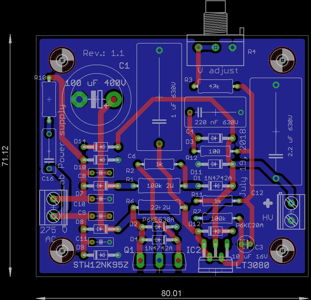

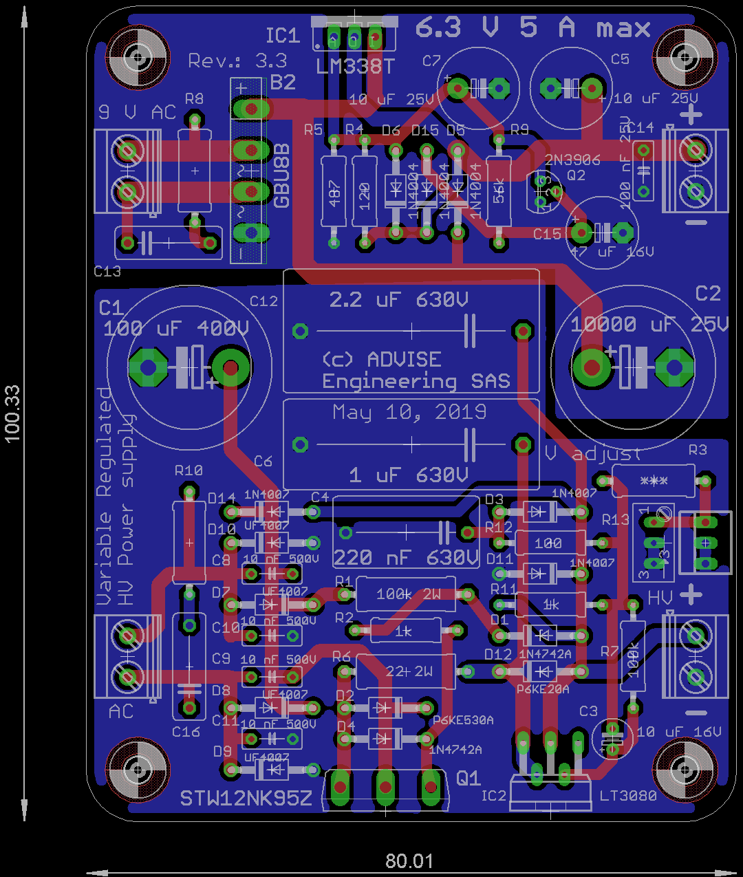

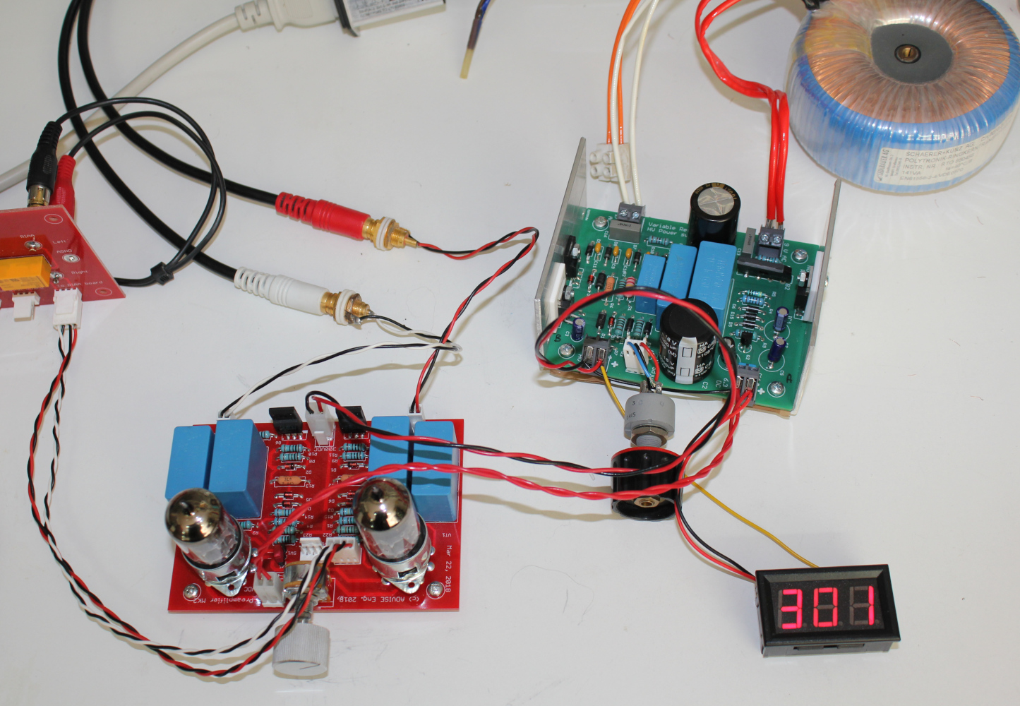

Some time ago I made power supply for my tube preamplifiers and amplifiers based on the Michael Maida high voltage regulator application note LB-47 from 1980 http://www.ti.com/lit/an/snoa648/snoa648.pdf , which of course since that date has been updated with a lot of new components with better specs which are available now, and Pete Millet designed an improved version with a MOSFET instead of a bipolar power transistor High Voltage Regulator and later Tom Christiansen made an other version with a better regulator 21st Century Maida Regulator, Rev. 2.0 ! My version is similar but since I am not familiar with SMD parts, I have designed a PCB for through hole parts, the result is very good 🙂
I made a version with a 6.3 V regulator for tube heater and a version with high voltage only for my lab power supply...
I strongly recommend this solution and for those that don't want to solder SMD like me, Tom even sell his version with these components already soldered 😀
Marc

Some remarks:
  • The compensation looks very summary, and more problematically, it depends on the voltage setting: when the voltage is minimal, there is practically no compensation left, meaning the regulator is certainly not stable.
    The wiper should be bypassed to the GND by a sufficiently large cap, and a resistor should be inserted in the - input of the opamp.
    Even so, the stablity is probably not going to be very good, because of the large voltage gain of the VAS and the output pole.
  • In case of an output short, C7 is sufficient to kill the opamp: protection diodes combined with a small series resistor should be added.
  • The base of Q5 should be protected by a small series resistor (eg. 100 ohm)
