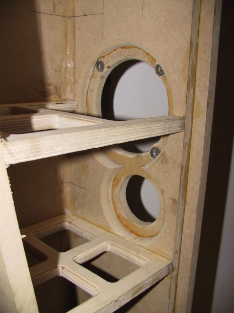

I used these for a few projects, along with 8-32 1" socket head cap screws, and I love them. I have removed and installed the drivers a few times, with no problems, unlike regular t-nuts, where they tend to slip out and fall into the cabinet. I got them when they were the Deal of the Day at Parts Express, about a year or so ago.
Brian

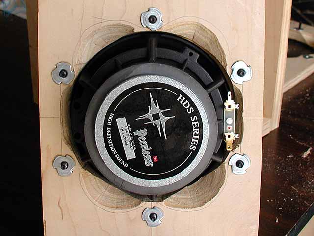

I have used t-nuts just once with good results. After I drill the whole for the t-nut, I drill 3 very small starter holes for the prongs. I put some super glue around the shaft and prongs. Then use a bolt to pull the t-nut in place. The bold is left in until the glue to dry.
