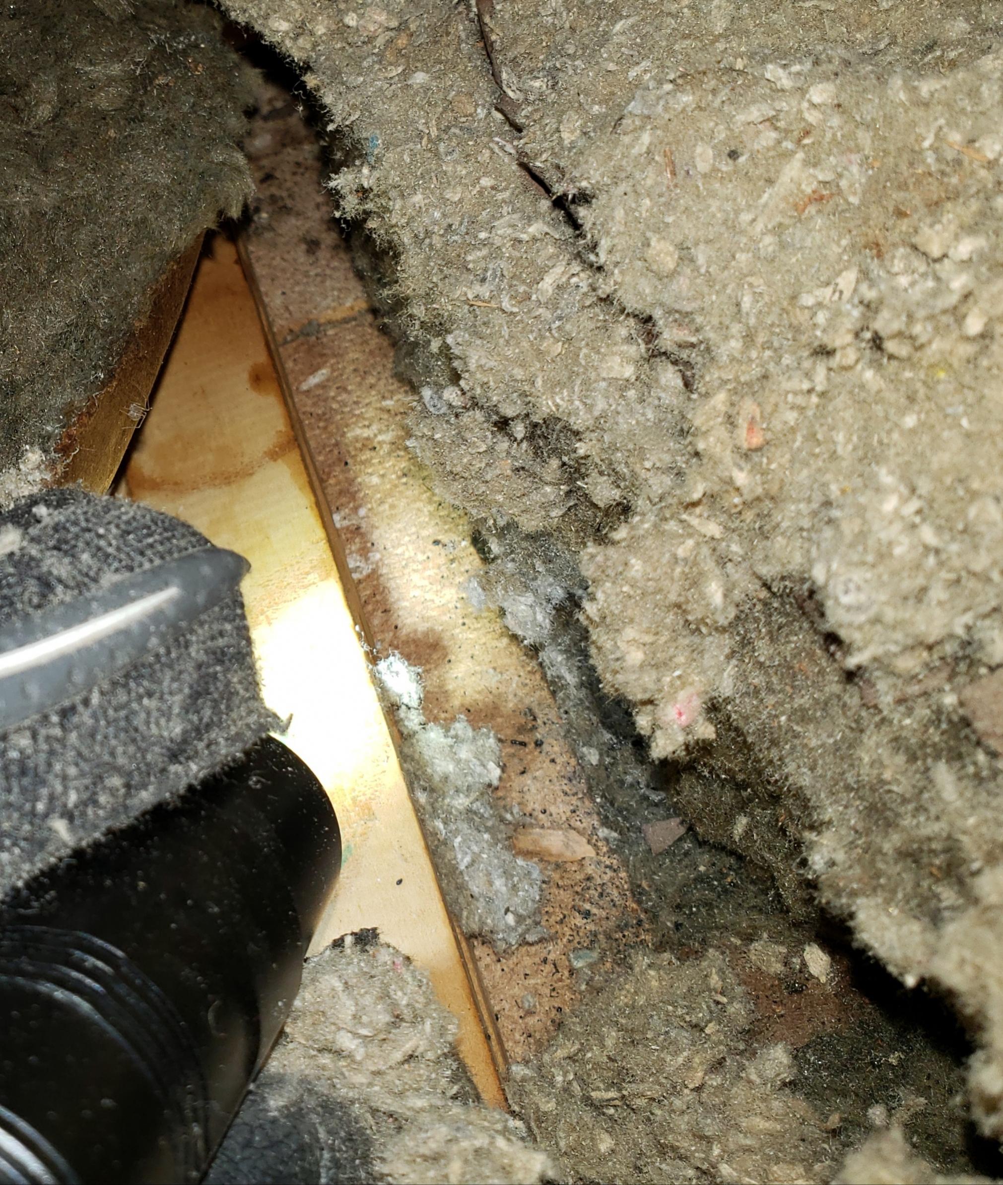

If you're pulling down tiles, and you have only the lathe work and there's no VR under it, what is stopping the blown-in from coming down? Sound like quite a mess. Wouldn't you be better off going over the existing tiles with the new? Are there any ceiling fixture preventing you from doing this?

Here in New England they are often installed on wood trusses to which they are secured with staples.
You wouldn't want to cover them because presumably they're soggy, and in FLA and even here in MA that can mean a wicked bad case of black mold growing in the tiles.
If you have blown in insulation hopefully there is something between it and the tiles like drywall - which if it got very wet should be replaced as well.
A reputable contractor should be able to handle the entire job including any messes from blown in insulation.
I was holding back the paper layer. It's under the bottom layer of lain insulation.
The black you see is probably the flashlight I'm holding.
If you follow the slat of wood up towards the top of the photo and look to the right you can see the seam wet ween tiles. When I tapped on the tiles, they sounded like mineral fiber vs mdf tiles.
I'm guessing that these are better for room acoustics than drywall but not the best for ac efficiency.
It looks like it all got wet - I have blown in insulation in my attic, and walls - it should be pretty fluffy. I would recommend you replace it all unless you want sick building syndrome. Not too big a deal if you address it now.
If the insurance will cover it (or even if they don’t) the proper way would be to remove everything including the wet insulation and start over. In the mean time decide what you want to put back. I would sheetrock it, that gives the option to tile it afterwards if the sound wasn’t right.
